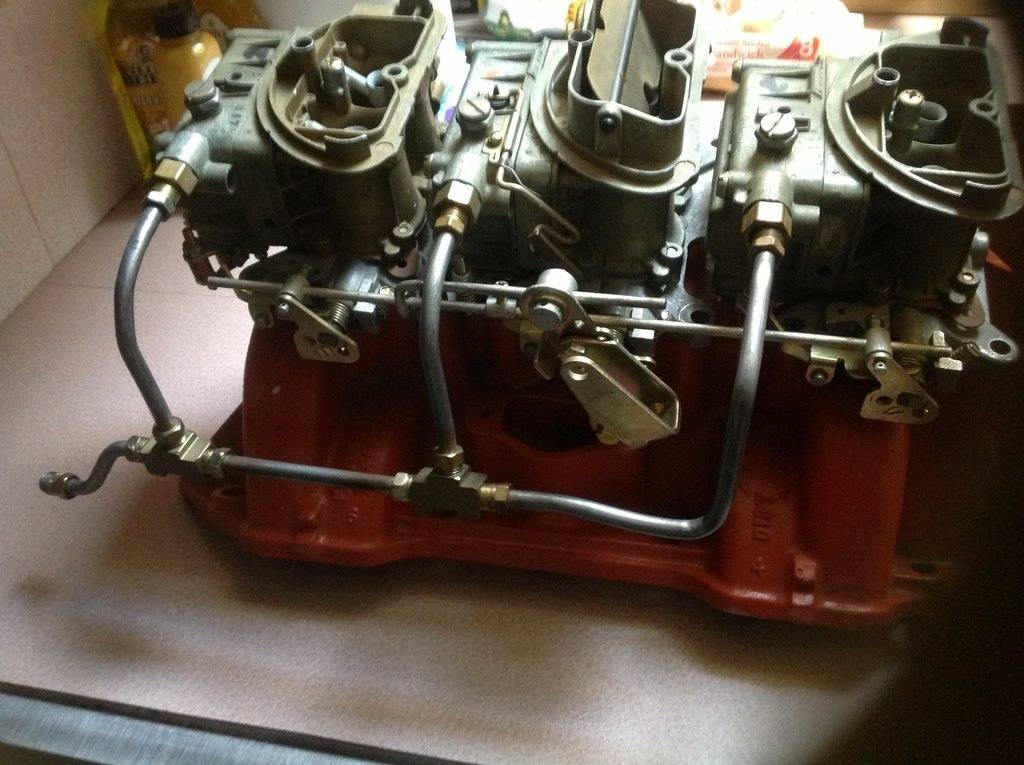

3/8 fuel line to factory carb lines

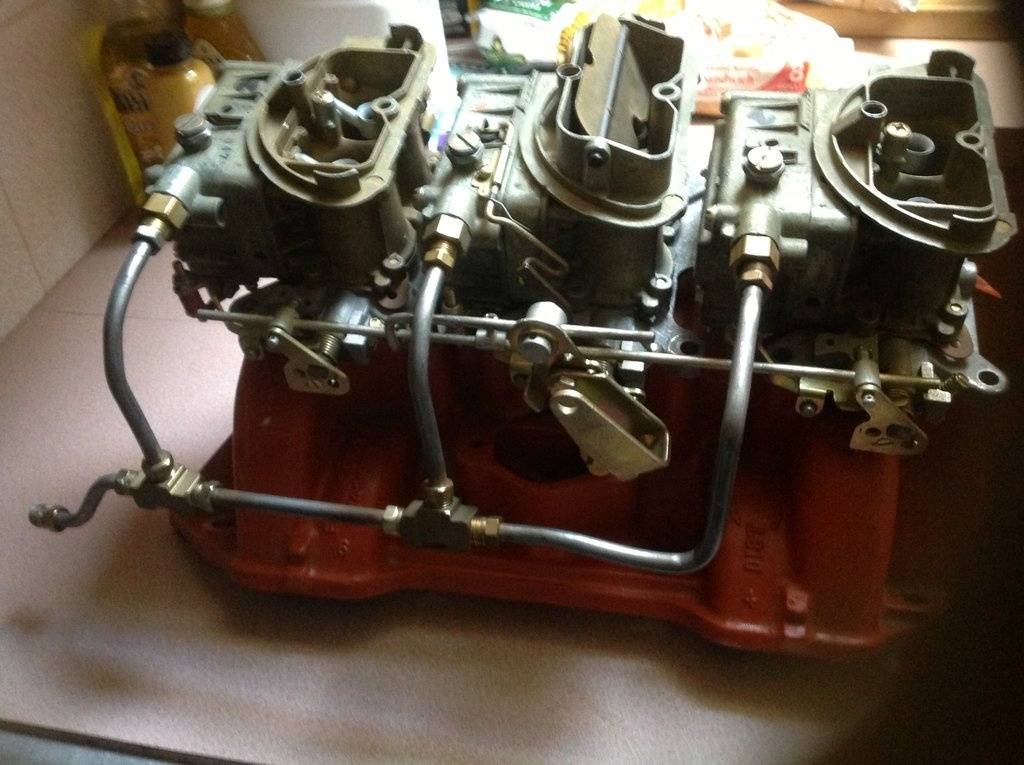

Here's my Six Pack set up,Mechanical linkage
This is the
ORIGINAL LINKAGE from BACK IN THE DAY
I found nothing jumping thru the 3/8" line hoop; but i always wanted to make a set. power is in the pump. you can't increase volume without upping pressure (unless there's some sort of restriction in the 5/16" line and its usually at the double flare). i found it to be a juggling act if you drive the car a bunch. the pump is where i'd put my time and money first.

Nice LEW! I have the original Direct Connection as in the above photo as that is my six pack,
I like the A+N with the braided stainless I was also going to install an in line pressure guage?
LEW is it advantageous to go to 3/8?
Thanks LEW + Six Pack BTW my fuel lines are on the same side as the linkage.
Mitch
i have a friend who has my old mech carbs and uses a braided hose and AN fittings. i think it's a pain in the butt for servicing the carbs but he thinks it's cute. if it were me i'd do a fuel log. you can do a 3/8" line to the log and 5/16" hose connections to each carb.
as a thought i went out to the garage and did a basic flow test with my parts washer. the parts washer only does 3-4lbs pressure. i stuck a brass fitting in the hose that is .250" i.d. to simulate the i.d. of 5/16" tube. it pumped a gallon in 50 seconds. if this was fuel at the carbs it would support well over 600hp. full throttle road tests on one my cars (app. 500hp), with pressure gauge and 5/16" line, showed the fuel pump to be the main player. i was getting 2psi at high rpm. re-worked the pump to get 4psi WOT and power gains were very noticeable.
another thought is the needle and seat assembly. everybody wants to go big and stock is .110" for all 3 carbs. we know two .110" in a big 4bbl can make big power with a high flow single plane intake. i think the three .110" may not give good fuel control. if i do this again i'll step back to .101". quick fuel had a tech article about .110" being a little large. three .101" have more area at the seat than two .110" and the majority of us can't come close to using all the fuel two .110" can flow.
