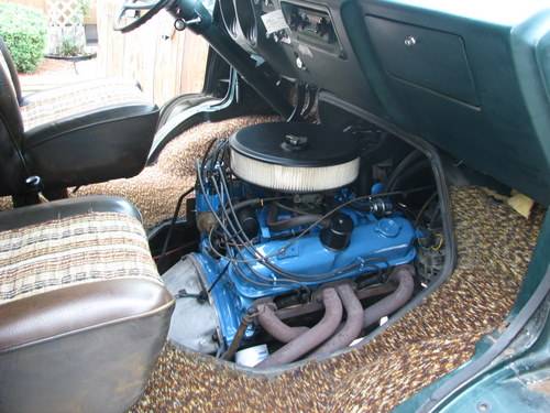

I've been doing some Xmas shopping for my Projects the past few days, trying to pick up some discount deals. I wanted to up the input on my '75 Tradesman B200. Original 318, on which I currently have a Holley 500 2bbl, stock intake, and headers. It's always ran good, but seemed like it could use a bit more going in for some better pick up. I was looking at Summit's offerings, and they have an Edelbrock Performance RPM Air-Gap, 7576, and a Holley Street Warrior 600cfm, 0-1850S. I was looking at Quick Fuel carbs also, but didn't actually pick one out. Any thoughts, or recommendations on this as to Brands, sizing, advice would be appreciated. Truck was a 3spd column manual, currently 727 auto, and 3:23 Dana, 11-15's on Rear, so it won't spin those on pavement !!!

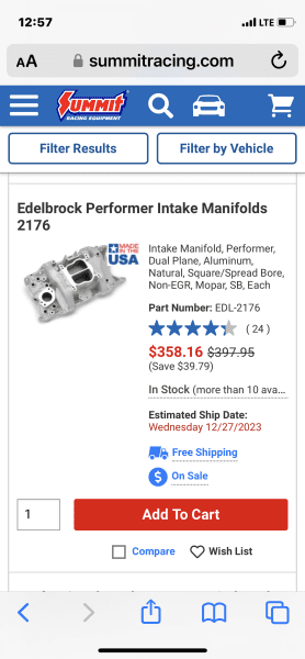

Thanks davek, I didn't notice lack of coil mounts, No A/C. I'll look into 360 apps...

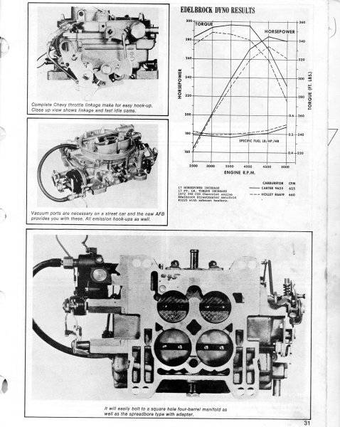

Below is a test between a 600 Holley & 625 Carter AFB [ EDel would be the same ]. AFB made more hp, more tq & used less fuel doing it....

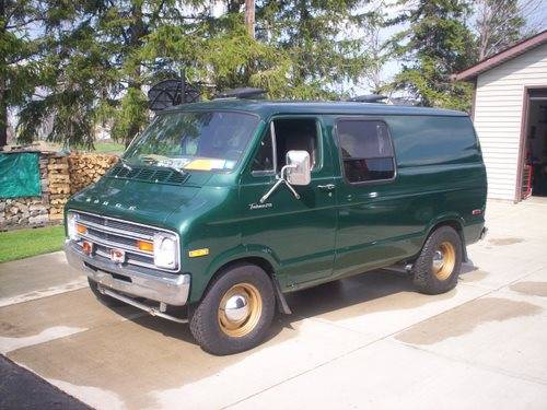

You can spend $1000 for a new intake & carb. or... search classifieds for a good OE 4-v iron intake w/ TQ for far less $$$. ( I like that Shaggin' Wagon, btw).
