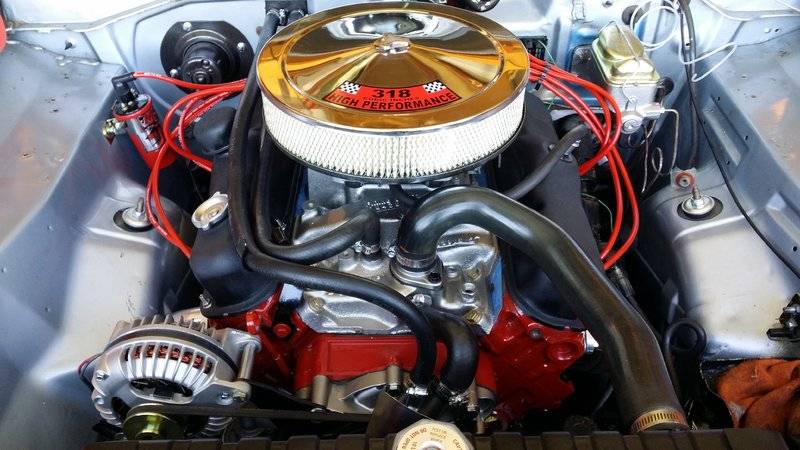

318 would like to go all in

Nah not hating at all! Buddy had a nice warm 318 on a 68 charger and it’s a nice car. A very basic 440 build will cost ya $5k and you’ll get that back all day in resale value. What’ll really will sell that car is having the numbers motor AND a nice stockish 440. Best of both worlds.
A world beating 318/39x will be a tough sell.

I have gone down the same path and probably in a similar boat being young and in this hobby when considering a budget. I considered the 5.9 magnum, I got a 400 and 727 but in the end a 318 is in the car because every other part needs more attention for the car to be drivable. The engine is a luxury item in the end. Unless you can spend 5-8k on a stroke kit, heads, valve train, transmission parts and machining for the 400 you probably will end up with them collecting dust like me. Buy them and sell the good parts... If you are going down the efi route, look at a gen 3 hemi. Good power, fuel economy and one big benefit over the big blocks is transmission choice: 727, A518, RFEs, Nag1, even the ZF if you are real dedicated.

Wee-18's as with any other small Engines, get knocked under the "no replacement for displacement" mantra which is very true.
That said....
NOTHING wrong with a Stroker Kit installed in a 318 and using any of entry level Aluminum Heads, they are surprisingly strong performers for the undersquare dimension, and the usable rpm range can be a gas on the street !
Some attention to gearing/tire diameter and mild stall converter is prudent if an Auto is used, but same as with any well planned build.

Most bang for the buck. 408 stroker, hopped up 904 trans. Ford Explorer 8.8 junkyard axle. Do it all yourself and could have an easy low 12 second street car for less than $10k easy.
Doug
I agree !
We've even used the 318 Blocks.... just a frigg'in RIOT on the street !

I'm kinda in the same boat. I just finished the first part of my 1970 Satellite. Meaning the body and interior are done, and its safetied and reliable. Original 318/904/8.25 combo with 2.71 open rear. While I wont be doing the engine this year, the tranny is going to get serviced and maybe adjusted by a local shop i trust (the owner is a Mopar guy). The rear is being upgraded with an 8.25 Sure Grip and 3.91's. Unless you're pushing more than 350 flywheel hp, the 904 and 8.25 will be fine. Assuming you dont abuse it constantly. Changing from the open 2.71 to a posi 3.91 will make the car feel totally different. Maybe even more than the mild 300hp rebuild it's going to get. I'll post again when it's done in a couple weeks. While I do own a 383 that needs rebuilding, I just cant justify going that route right now for a near daily driver. If I wanted to build for street/strip, I wouldn't have started with a 3600 pound, 19 foot long car. Anyway, just my opinion. I'm pretty new to Mopar but am loving cruising now that its driveable. Good luck with your build.
Don't forget that the 318 magnum has a reverse rotation waterpump and that the stock timing chain cover does not have a spot for a mechanical fuel pump. Which means you would need a electric fuel pump and a reducer/regulator with carb or run efi. Also previously noted by others the flexplate/flywheel will be externally balanced vs other small block (except 360la)
