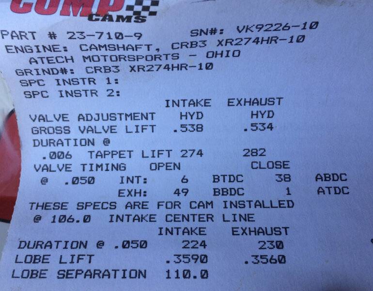

I had the block decked .020 which actually brought me to .002/.003 out of the hole. Head gaskets are just standard .039 Felpros. The cam is the Hyd roller below, I use solid roller lifters and Harland sharp rockers with lash around .005 cold. I do not have the measurements you are asking for as this cam change was done on a running motor without pulling the heads, I do however have a video from the borescope somewhere, I’ve shared it on here before. Cam is installed “strait up”. It’s the cams with lots of duration and a late exhaust valve closure that will cause the first interference problem, piston don’t care how far the valve opens so long as it gets out of the way before the piston gets there.
I think you are doing very well... and obviously haven't experienced any Piston to Valve issues.
Did you check the Piston to Valve Clrc with the 224/230 @ 050 Roller Cam ?
I'm thinking your Composition Head Gskt (+.020") and small duration Cam/Valve Heights after rebuild may be helping keep things away from each other ?

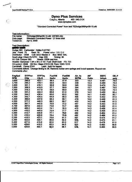

We've made 444 Ft Lbs with 430 HP on the Engine Dyno on a 383 using 906 Irons and just the Comp XE274H Flat Tappet Cam at 224/230 also, probably similar power to yours, albeit NON-Roller
I did check it, but with a borescope turning the motor over watching the events. There was never anything remotely close needing further investigation. So i sent it, alot. I do intend on having the heads off this summer before my #MoparVsBrandXstreetcarShowdown this fall in Alabama so Ill try to get some of the questions answered then. I already have the headgaskets in the closet for the job some Cometic .036 ones that arent hoola hoops around the 383 bores. Going to do some tweeks to the heads and put it back together. New converter and a 3.73 set, trying to get the car around the 7.60 range and 90mph and then... leave it there, it's a mule for my Ratty Muscle Cars races.
