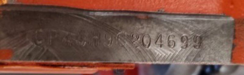

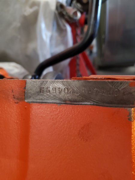

This is the pad number. To me it looks like the pad was ground by the looks of the uneven mill marks.
CP45H9C204699 = 383-4bbl (H) out of a 1969 (9) Chrysler Town and Country station wagon (CP45) built at the Jefferson Plant (C). The mill marks are fine. It's when they are missing we get suspicious.
