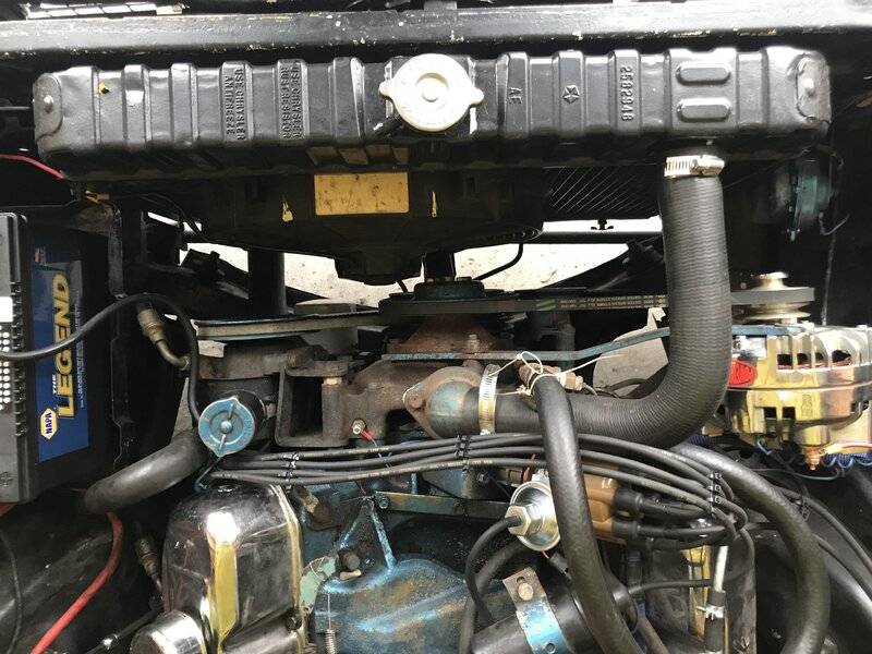

I acquired my 66 Coronet station wagon last fall and am still getting a feel for it. It is running hot and my local radiator shop and I am working on troubleshooting it. The guy at the radiator shop says for an engine like this running at 220 is not a big deal but from everything I have read that seems pretty hot. Seems like closer to 190 is ideal. The car has an electric fan (installed by the previous owner) and we realized it wasn't working so we fixed that but that didn't seem to be help much. We have also changed the thermostat (the previous one was in upside down) and flushed the radiator. I have yet to take it on a long drive but in the short trips I have taken, even on the open road, it seems to be running way warmer than it should. Has headers now but I have exhaust manifolds that I am looking to put back on once I get the chance. Thanks in advance for your suggestions.View attachment 966190

Lots of good info. Question what is the source of your temperature readings u say are high? The dash gauge? I’d get a non contact thermometer, mentioned somewhere in comments, and check the actual temperature of the coolant first. Maybe the problem is the gauge. Did anyone mention cleaning the outside of the radiator?
Sir, I run 383's and 440's here in Texas mid-day in July....in traffic....outside temp 110. Like Kerndog and other have said.....shroud is essential. Also, sending unit calibration too. Do you have a laser thermometer? I use to to check my temp gauge. If you have not flushed the system....do so.....then, make sure all the basic stuff is working. Thermostat, lower hose spring and all the normal heat issues that arise. Also....your fuel system.....you running a spacer on your carb? Is she tuned right? That can have a huge difference....dump the electric fan.....idle heat loading can be an issue with a stock system, but that fan is too small.

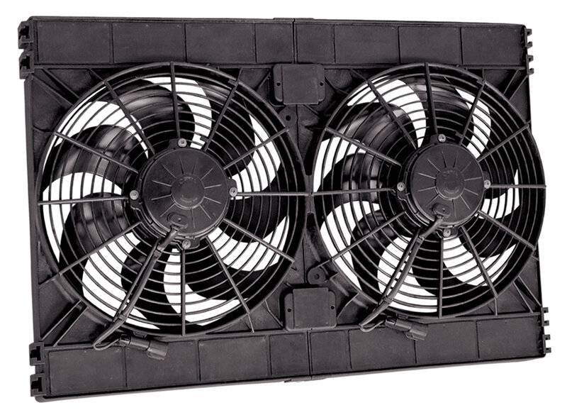

220° is getting warm but not overheating. You didn't mention what degree t-stat you put in. Try a 180° and make sure your cap is good. I know fan blades are a power drain but they are quite efficient and with a shroud they can be even more so. A thermostatic clutch operating properly doesn't take much power until it locks up. Most drag racers don't use them. The electric fans are easier to control but you could use more fan. Your single fan, regardless of how much air it pulls, only covers 1/3 of the core. You need another one at least. Something like this would be good. Late model fans from the salvage yard may be good choices as well.
Where is best place to order a fan like this? I agree, now that it has been pointed out by the group my current fan covers less than 1/2 of the radiator.

Here's my fan set up. 1 Spal 13" 1750 cfm fan, 1 (cut from factory shroud) Ford Contour fan in custom shroud covering entire radiator. Then 10 - 2 inch holes with rubber flaps over them. Allows full airflow while cruising and allows fans to pull all air through full radiator surface at slow speed/idle. A/C froze me out while idling for 20 minutes waiting for an accident to clear in 110 temps yesterday. FI computer showed engine get to 208° max during that time. So I think they are working well.
