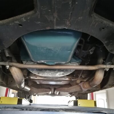

My 66 Charger was a 361 two barrel. It uses the low performance manifolds and the previous owner had a 2 1/4 system bent up. Seems like they cut the Y pipe and used the stubs and sleeved the new pipe over it. It has huge mufflers and is very quiet.

This car came stock with 2bbl, single exhaust and I still need to find the manifolds numbers, but I'm sure it's all original. In fact it had drum brakes on the front end. Go figure. Living in the hills of San Francisco at the time I had to convert to discs. That's the only change I made. Opening up the exhaust was stressed by my hot rod brother as an important minimal improvement. I don't think upgrading manifolds is in the cards. That would lead to many more "improvements" that I'm sure would make it a runner, but I'd like to keep it simple and stock for now. It looks like Magna Flow stocks the manifold connector pipes (https://www.magnaflow.com/collections/1969-dodge-charger-exhaust-systems). Please let me know if you think it will not bolt up. Thanks for your input!
I don't think it will bolt up.
If you want it to look like the factory duals, Accurate would be your best bet. I have used them in the past with good results. Remember you will also need to get a drivers side hanger bracket as your car wouldn't have come with it.

I measured the existing exhaust pipes finding 1-3/4" head pipes joining into 2-1/4" to the single muffler. The muffler measures 10"x 20" with a 3" inlet and 2-1/4" outlet. The tailpipe is 2". Someone installed the muffler for me long ago and filled the in/out with lots of welding to match the pipes. I mention all this because it brings up another question: Do the diminishing diameters serve a purpose such as required back pressure?
I called Accurate Exhaust and found they can make a bolt up dual system conversion including the head pipes and flanges. 2-1/4" throughout including 20" factory mufflers, and over axle turned down pipes.
