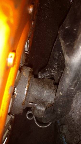

probably not the problem, but a few years ago I bought a couple of spare clutch release bearings from Summit, and when I tried to install them, they were wrong. On closer inspection they turned out to be total junk, and came apart in my hands. I ended up buying from Brewer's (should have done that to start with) and problem solved.
Was this picture taken with someone pushing down the clutch pedal or not? At a glance, it "looks" like the throwout bearing has slipped off of one side of the clutch fork, so maybe the clutch for "holding tang" (looks like an old beer can punch) slipped off of the "pivot" on the bellhousing. You might have gotten lucky.
With nobody's foot on the clutch pedal, that throwout bearing should be back off of the pressure plate fingers...maybe 1/4" or so? At all times, those little "loop spring wire ears" on the throwout bearing should be clipped over both "tines" (fingers) of the clutch fork. It sort of looks like the fork "tine" that's behind the throwout bearing in your picture has slipped off. Since the throwout bearing is installed (transmission input shaft going through it), it can't get cocked sideways itself, so it looks like the fork is what's crooked....aka... slipped off the pivot in the bellhousing during installation.
