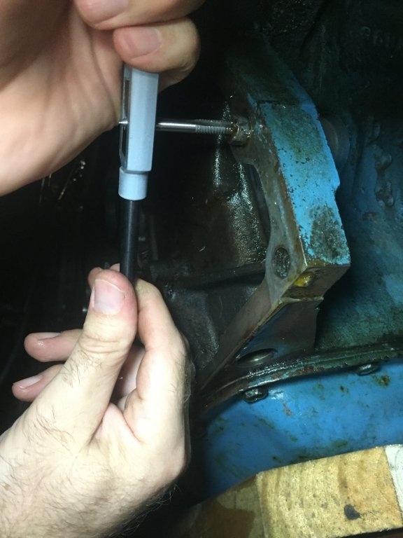

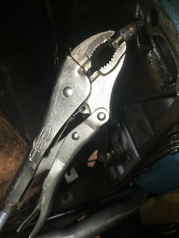

Dowel pins are typically hard, at least case hardened. When I drove a center punch into the end to get the drill bit started, it made a nice indent. I had a sharp carbide-tipped 3/16" masonry bit on standby, but it was not required. After drilling a 1/8" pilot hole I was able to graduate up to a TiN coated 13/64" bit, then successfully tap 1/4-20 in. threads. Sprayed PB blaster through the new hole, inserted screw and started smacking it with my homemade slide hammer.

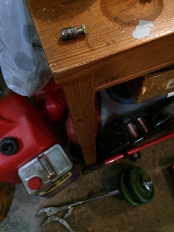

After about a dozen good hits (using two 5 lb plates) it popped right out! Note I had drilled at an upward angle so the 1/40-20 screw looks skewed but it held on for dear life, and unscrewed easily afterwards.
Here's the dowel pin on the table. Homemade slide hammer on the floor. The threaded adjuster in the vice grip handle was replaced with 12" of 7/16" all-thread. Even though not directly in line with the jaws it did the job. Total cost minus vice grips and weights - $12.

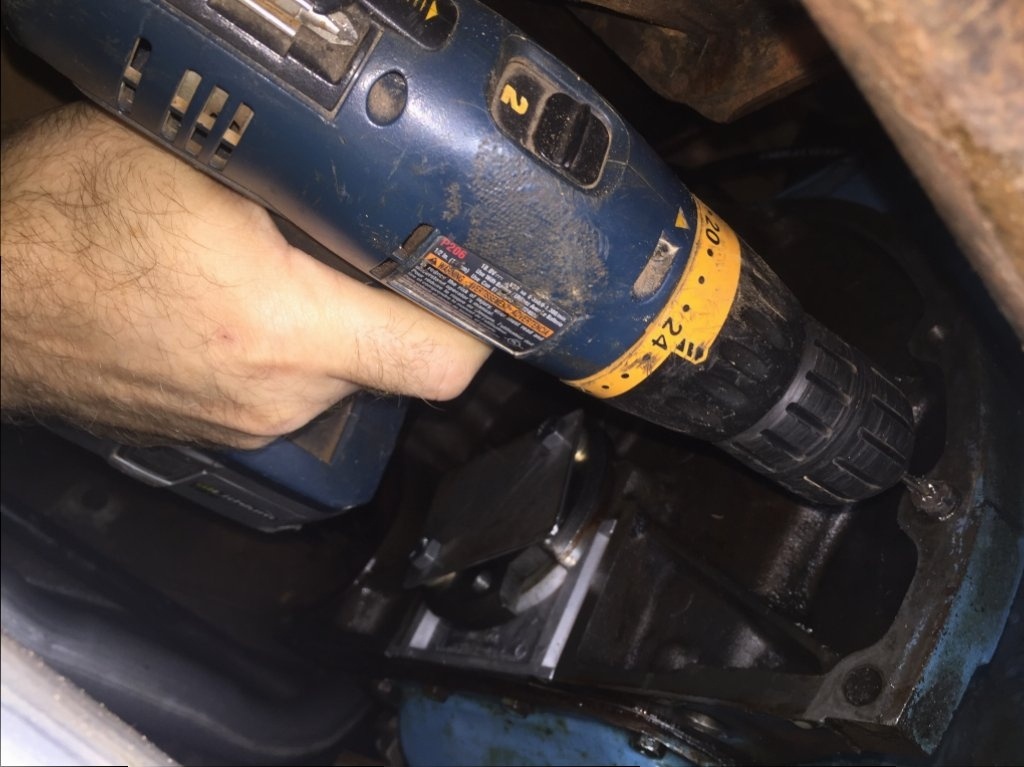

Access to the upper left dowel pin was obscured by the firewall. For the purists in the crowd I will spare them the picture of how we removed it, but it involved drilling a 1/4" hole just beside the gas pedal pivot and attacking from inside the vehicle. The hole is easy enough to patch - it was like minimally invasive surgery.
We tightened 2 nuts on the end of a 12" piece of 1/4-20 all-thread, which proved strong enough to yank out that dowel.

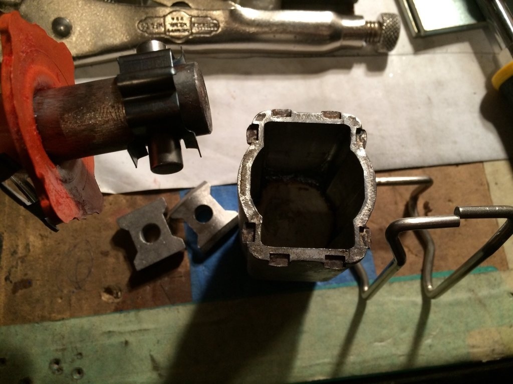

So after what was probably too much consideration I decided to rebuild the steering coupler. My biggest concern was the cap popping off without proper crimping. The factory crimp of the tabs works well but the replacement cap requires careful installation to keep it in place.
The spring above is circled for no particular reason but it just happens to be the only thing visibly worn out. All the old grease was pretty nasty as you might expect.
Maybe over-thinking it but I purchased a spring retainer off ebay just for good measure (on the far right in this picture).
Pretty straightforward but critical - it's just one of those things I don't need to worry about while running down the road.
This is the best I can get it. The cap feels secure but the retainer clamp will give me even more confidence.

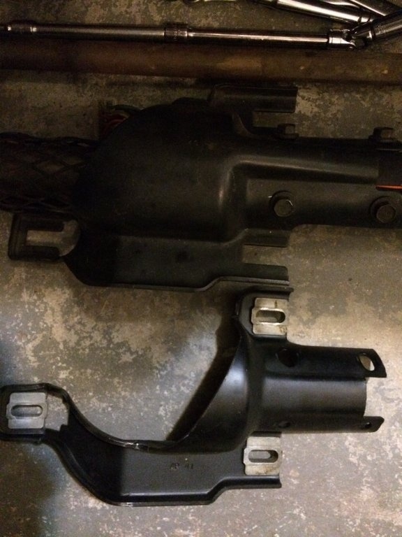

The steering column mounting bracket changed from 1967 to 68/9. Most notably the 3 break-away washers are aluminum for 67 and later years are nylon. This looks like the last major difference between the late 60's B-Body steering columns.

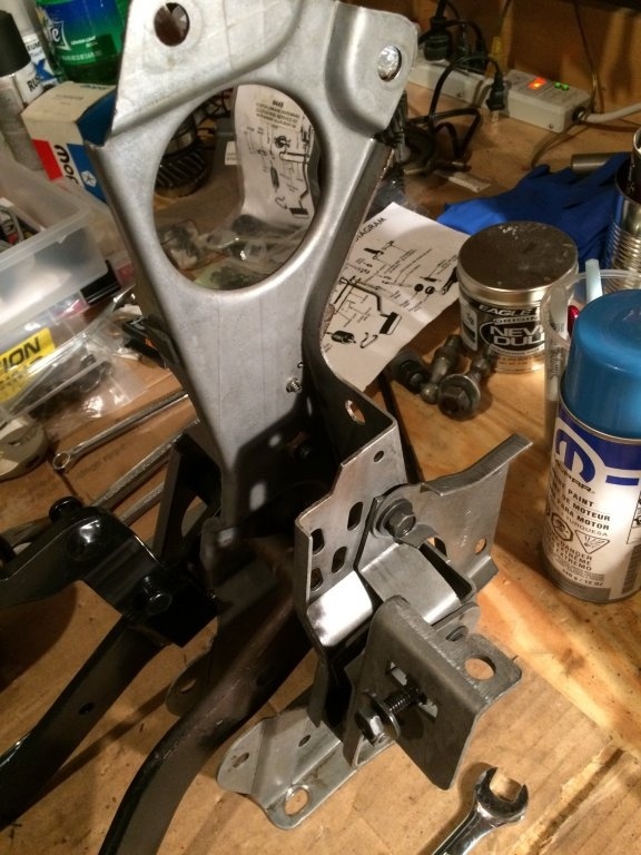

The pedal assembly looks all innocent here, but it put up quite a fight. It would help to be a contortionist to get this in place as it bolts to the firewall, under the dash pad and behind the instrument panel.
Finally we have the third pedal.
I left out the overcenter spring since the clutch is a diaphragm type.
