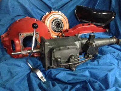

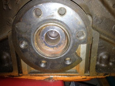

I recently purchased a 73 Roadrunner that I want to convert to 4 speed but was put off by the 3 to $4k kit prices. I came across what appears to be a decent deal on a rebuilt 23 spline 833 with receipts, big block bell housing, zbar, clutch, shifter and cross member from a 68 charger for 1700. I already bought a cast crank 440 for it but am not sure if the crank is drilled completely to accept shaft. Can anyone tell from pic below? Or will I have to cut snout and use conversion bushing in the converter register? I would still need to find pedals, flywheel, floor hump and console components as well as pistol grip handle. If I can get it done for 2500 I think I'm doing well. Any advice? Thanks.
00404_jEceHGAVwMj_600x450.jpg:)
Here is a pic of of trans and parts. Is that the correct position for shifter for my car?
Based on the picture, it looks like you just need to put a pilot bushing in the crank and you're ready to go. I have the tranny out of my car right now so I can get a picture this weekend of what it should look like with the pilot bushing if you need it. The four speed hump is available from Year One and other sources. I'm not sure about the pedals. You should be able to find used ones without too much trouble.
The arms should be pointing up, not down.

Looks good but you need the tail housing that mounts the shifter near the back.
I believe you need a different tail shaft housing to put that setup in you car with a console. Or I should say you would on a 71-2 Road Runner GTX. I'm not well versed in 73-4 but in 71-2 your shifter would bolt to rear of tail and then uses a different trans cross member and mount than your donor Charger.
Also it looks like that crank has a Brass Bushing in there already.

You DO NOT have the correct tail housing or shift rods for a 73 RR but it's not hard to remedy. The tranny will have to be partially disassembled to make the tail housing swap and shift rods will have to be sourced. Also I noticed the shift plates on the side cover are installed up side down. The crank pilot hole looks right.
