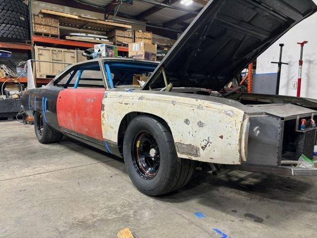

Almost time to get back to the Bird and get her finished up.

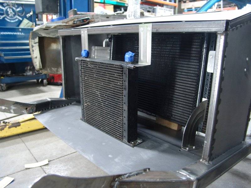

Starting to get back to the Bird. I mounted the A/C condenser and the oil cooler.

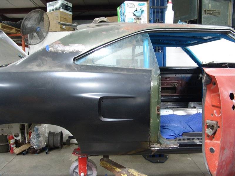

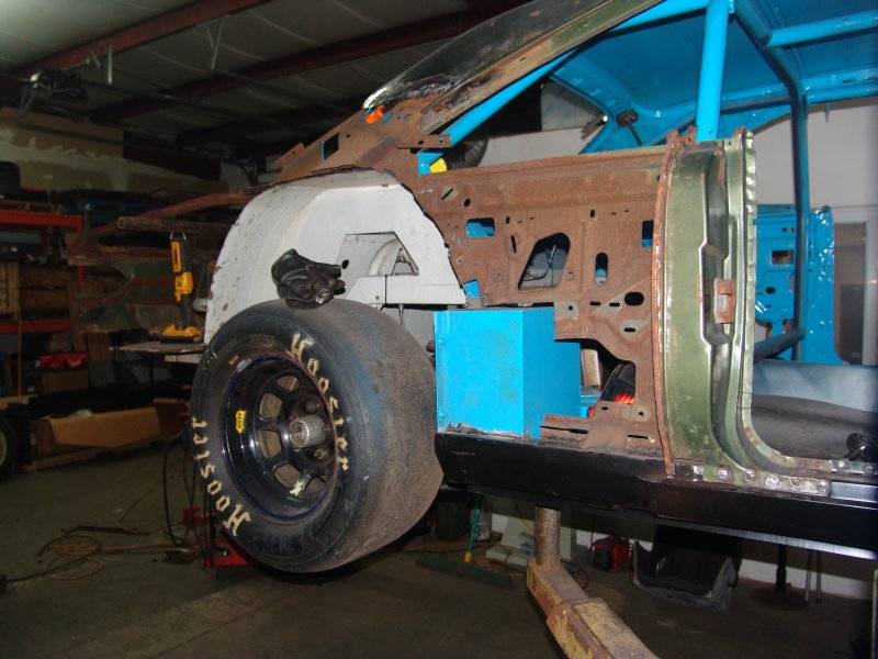

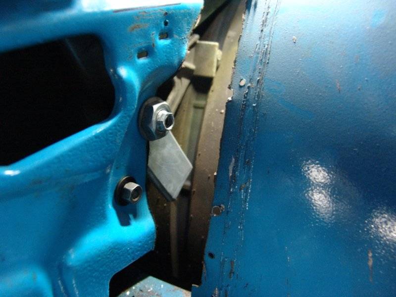

Been trying to figure out what I was going to do with the rear side windows. I was figuring they would be permanently up or make removable. Ended up buying all the rear tracks and parts to see what we could do. With the axle up way past where it will ever go it was right at the window. At normal ride height I'll have about 4" plus of up travel before it will hit. So I'll I had to do was modify the wheel tubs to clear the window when it's down.

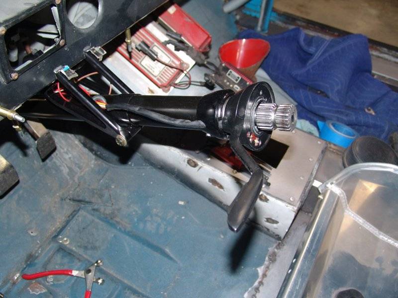

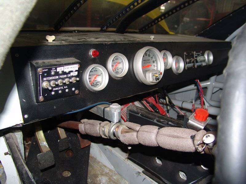

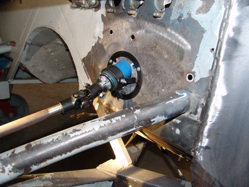

Needed to add turn signals but the original Nascar steering column had no where to mount a switch. I ended up going with a Speedway Motors hot rod column.

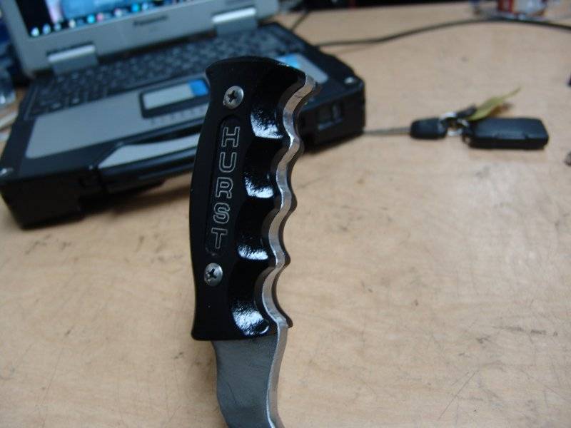

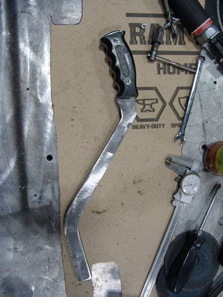

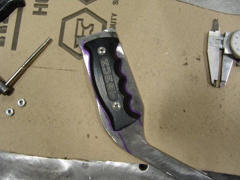

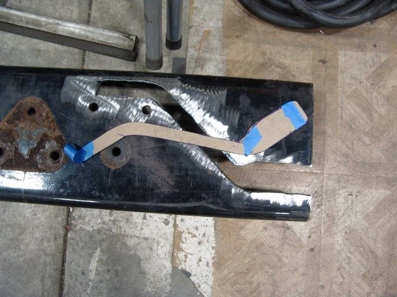

I wanted a pistol grip shifter but didn't know if any of the factory one's would work in my chassis. Looked like a 71-74 B-body bench seat shifter was close. I ended up making a template off the one that came with the Nascar chassis.

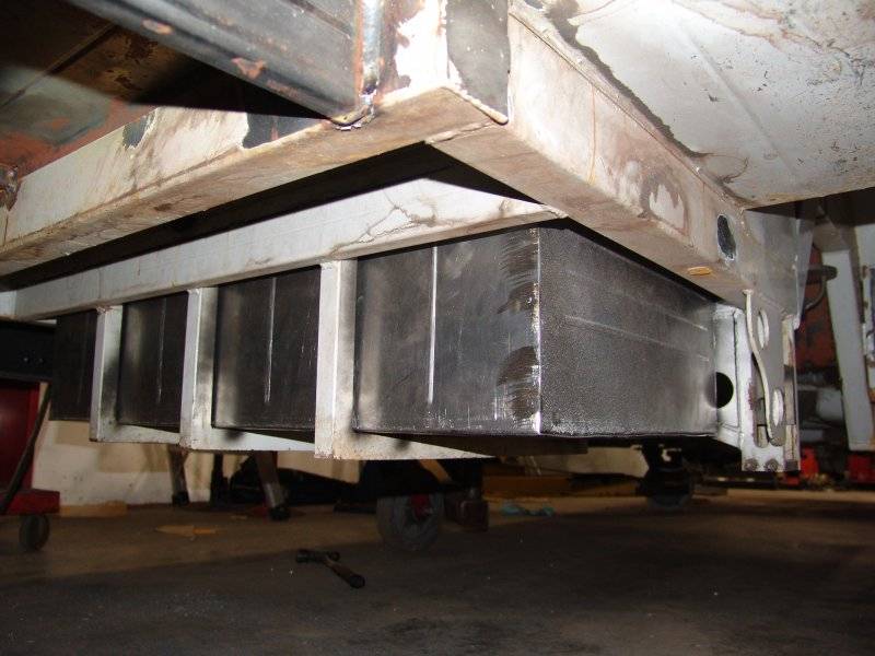

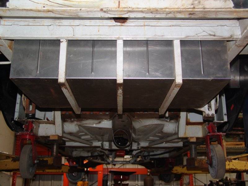

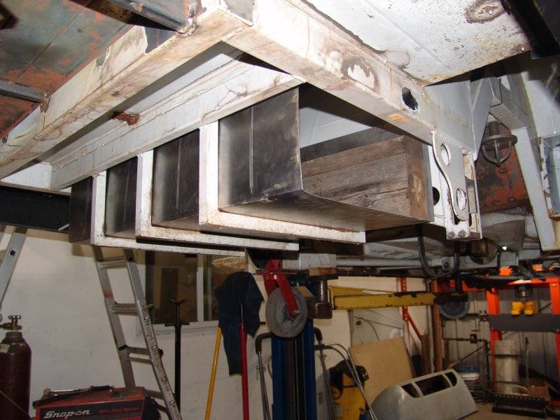

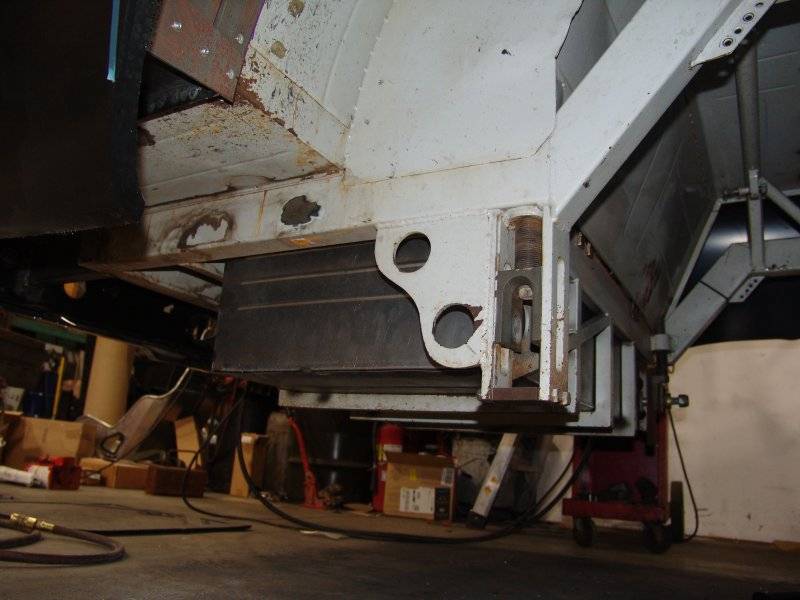

Removed the dented up fuel cell compartment and started on the new one. I'll get the side done tomorrow.

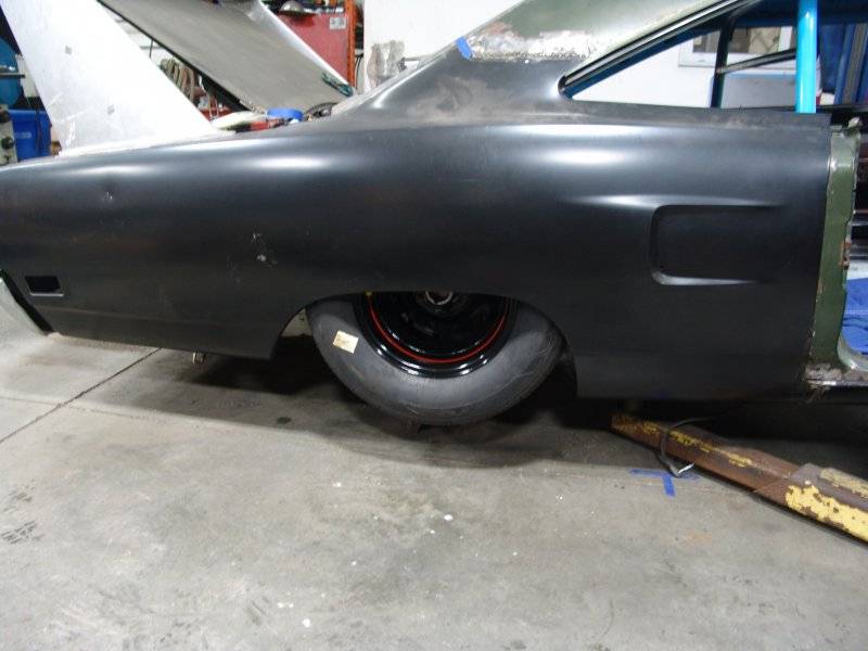

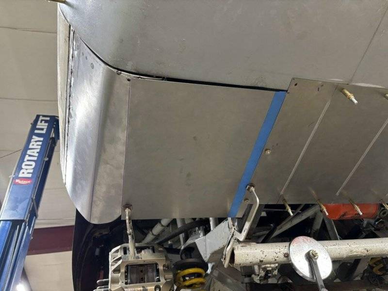

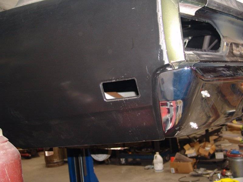

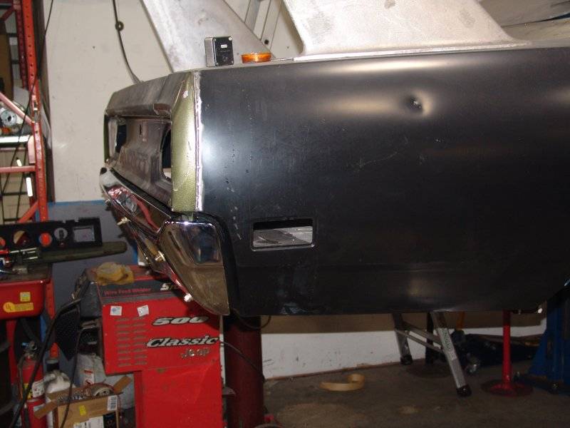

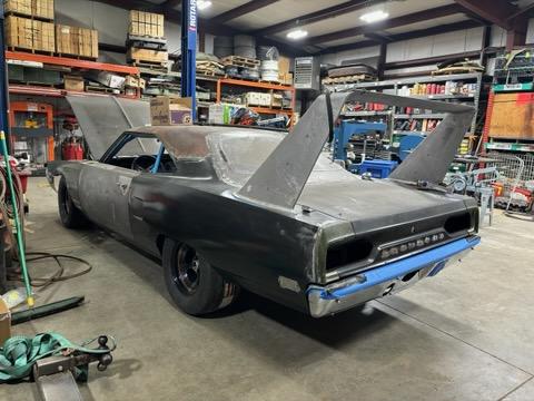

Building new fender extensions and belly pan. Sure glad I didn't hack up the original ones.
