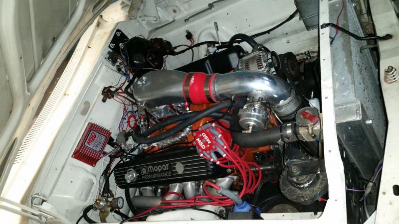

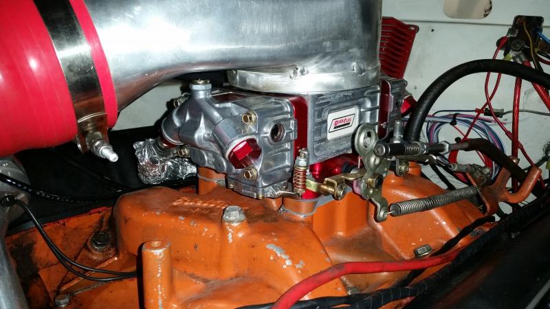

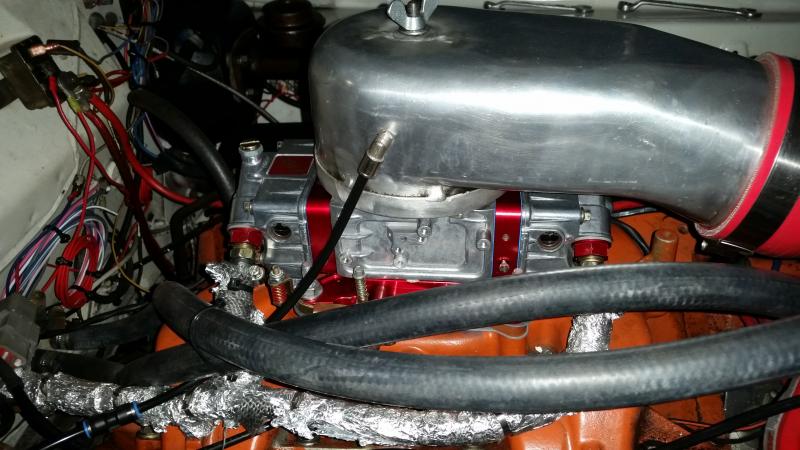

My setup
Check the temps in a few places after full warm up with a digital laser temp gauge. Let us know. Hot start with half throttle not bad. See you have your lines wrapped.
