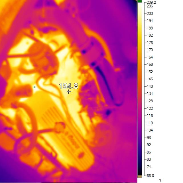

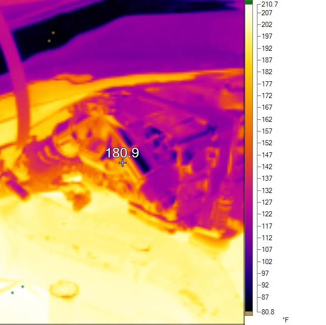

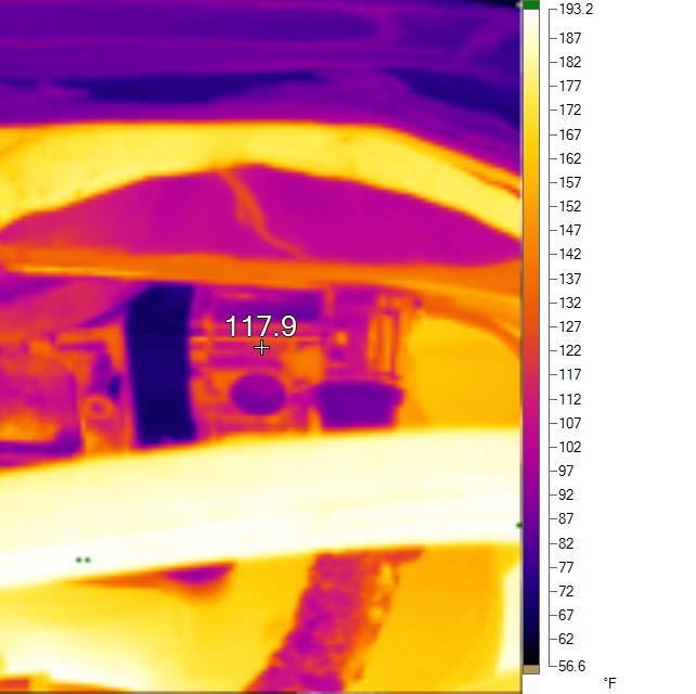

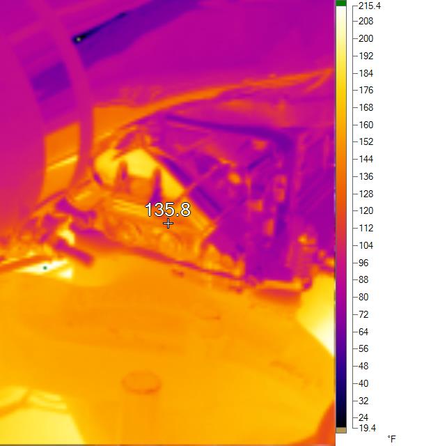

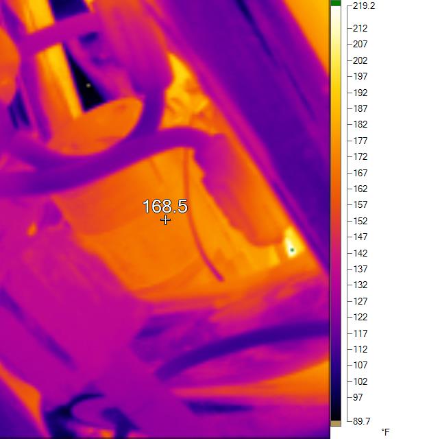

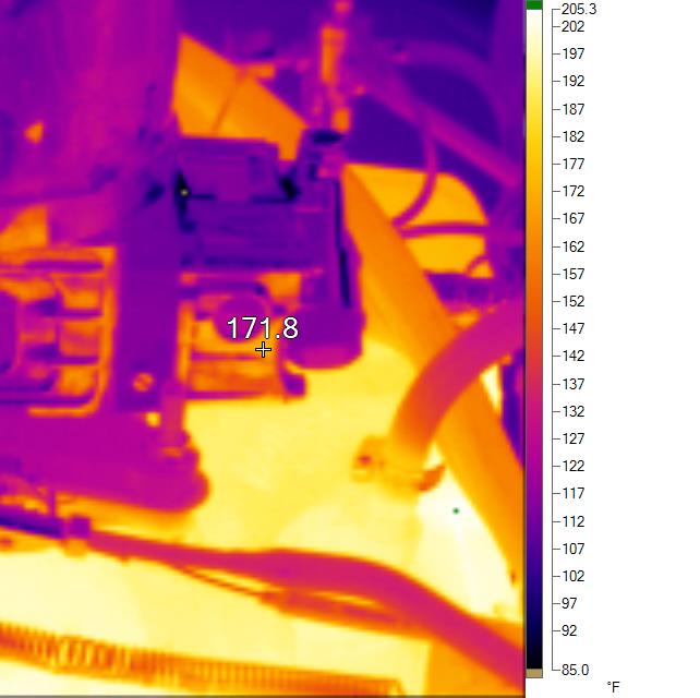

Today there is a small car show in town and the weather is on our side so FINALY i can do some testing and take som pictures with the thermalcamera. I´ll post the pics as soon as i can.
The first pictures is when i got back after a test drive... the others after sitting 15min with hood closed. And one picture of the starter after 15 min.. just for the fun..
The outside temperature was around 50F.
