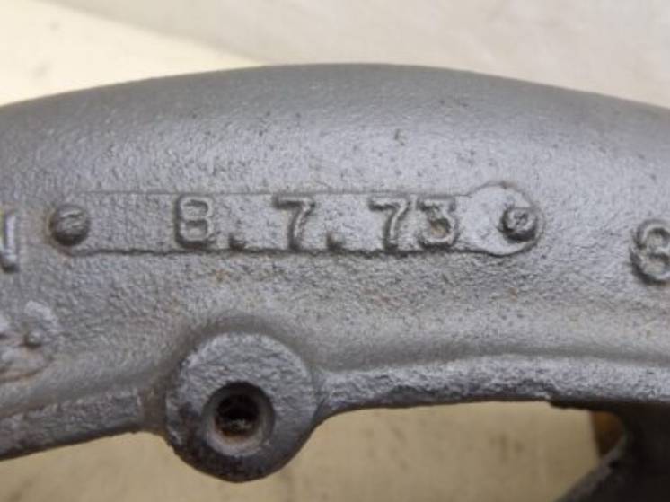

This is for reference 1974 piece
Exhaust Manifold Casting# 3751068 - LH - Date - 8-7-73 - 400 / 440 HP - B - Body - 1973-74 - USED - SHIPS FREE TO LOWER 48 - Blue Star Performance
