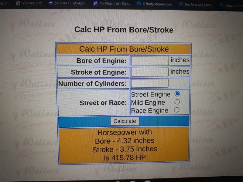

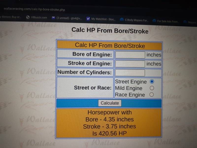

more cubes don't equal more hp ? 401 nail head buick 325hp,445tq. 425 nail head 340hp,465tq. same carb same cam same compression. on a 440 engine going from a 4.32 bore to a 30 over 4.35 bore = 5 hp

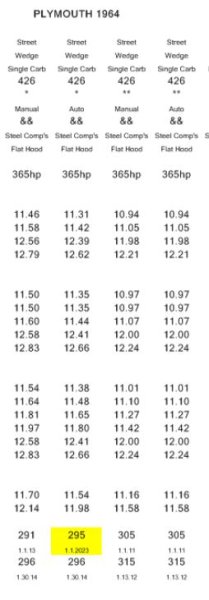

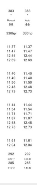

They are not the same carb, but a 64 Ply 383 and 426 SW have the same carb cam and heads with the 426 having a hair more comp and being able to use a bit more duration in NHRA Stock, over the years NHRA has factored them within 3 HP of each other and there are more cars running the 383 than the 426 SW.
yes your right 625 vs 750

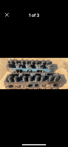

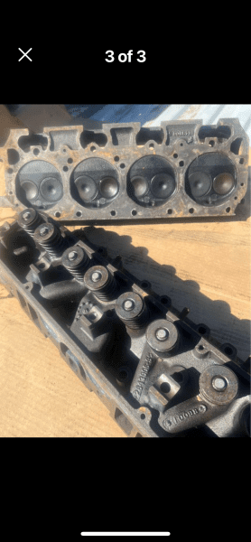

After some reading last night, I discovered that my ‘67 Newport parts rig possibly has sought after 915 heads? They sit on its 383. They’re fairly rusty on top. Somehow condensation crept up to them.
I’ve never rebuilt heads but I do know they sell the springs, rods, keepers, etc. Do you guys think it is worth rebuilding and then go onto this 440? Should I just find 906’s? Aftermarket? Thx!
A 67 383 would not normally have 915 heads. Most likely it has 516 heads. 915s have a soft plug on the ends...516 don't
If they were 915s ( unlikely but possible someone put them on) Yes I would rebuild and use them over 906' s.
Most likely need the big exh valves installed
383 never had 915s. If you have them, someone put them on.
My first choice is aftermarket aluminum, second is 915s.

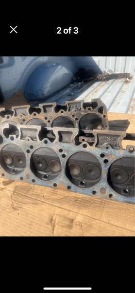

Here are some 906’s that popped up near me. They seem to look ok.
906's?

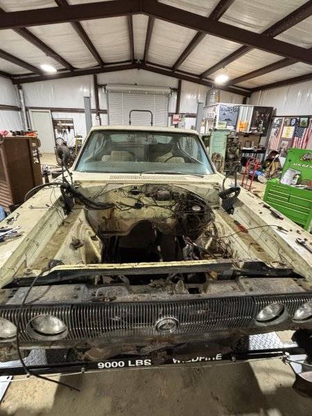

Ok. Going to need some help on a few things. Things I’ve done so far:
Pulled the 383 out of my 66 (not original & overheating). Dropped in 440. Had to use my motor mounts from my 383. And use 383 manifolds as the 440 had center dump exhaust. Also swapped the leaking 727 out with my ‘68 Imperial’s 727.

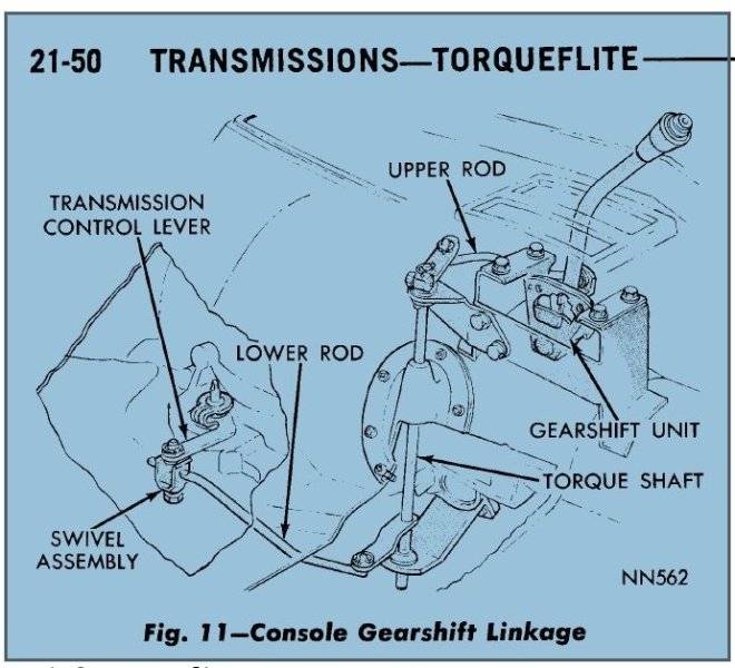

When I pulled the 383 and trans, I thought I had everything disconnected. I didn’t. The shifting torque shaft was still in place. Well, I bent the shaft pretty good. I tried bending it back but it’s tweaked pretty badly.
From this diagram, it appears it was straight up and down and went into the ear hole on the transmission. After dropping the motor in (both mounts bolted up), it isn’t even close to lining up. I guess I could rob the shaft linkage from my other 66 Charger for the time being. I need to inspect the shifting linkage anyway. Maybe that’s why it’s not close to lining up.
Thoughts/suggestions?
