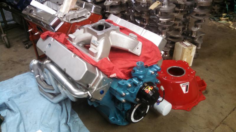

511"
4.375 bore 400 block, aluminum main caps and studs
6.535" Rod, 2.220/.990
Diamond 1.32" CH -12.5cc reverse dome pistons, tool steel pin
Ching chong wing wong crank offset ground to 4.25" stroke, .2.200 rod journal from a Chrysler journal 4.150" crank.
Edelbrock Victor MW heads CNC ported by Hughes and cleaned up a some by me in the chamber and valve job.
Manley TI retainers and locks
ISKY 9999-RAD springs, [email protected]" / [email protected]" lift
B3R rocker shaft relocation / geometry correction kit.
Hughes 1.7 ratio rockers
Trend tapered 7/16" push rods
Jones custom roller cam, .740ish lift, [email protected]
Isky Red Zone lifters w/ EX-roll option, .180 intake offset due to offset intake rockers due to offset intake ports lol
HV oil pump
70-71 "HEMI" 6 qt. oil pan
3/8" pickup
Indy 400-2 intake cleaned up a bunch.
4150, 1050 cfm QFT Q-series carburetor
Monte Smith Big Shot N20 plate
It's all going in my red '66 Charger mated to a G Force GF5R 5-speed backed up by a Dana 60 with 3.54 gears.

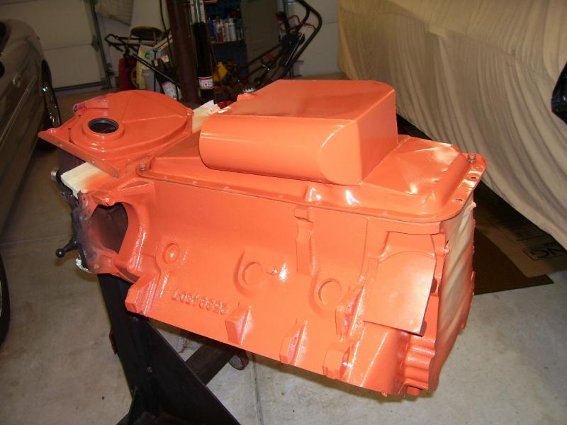

i've got one of those road race pans on the bench that i might use. i was playing with the trap doors with some parts washer fluid and got a little alarmed at how well the chambers trapped fluid. i'm not sure they'd make a good drag race pan, only 7qts. i know some folks do. i made a pan that has the kick outs for my '65 coronet driver (7qts), no trap doors but vertical baffles from the top down on the sides and full perimeter baffle over the sump. not sure it would be a good drag race pan.
