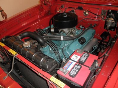

The 426 Wedge is a 0.060" over 413....
Sonny has a ..............413, 426 Wedge is a 0.060" over . not too shabby, it can get up and go. well sort of:sleepy2:
