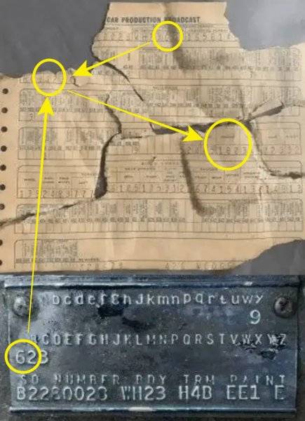

To the left of 426 wedge is a box Remarks with numbers. Where it says BROADCAST what is the letter below the B?

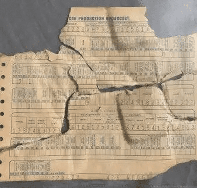

That’s what I’m trying to figure out, body numbers match, sequence numbers match, everything matches, except the motor code, and the build sheet says 426 WEDGE at the bottomThat broadcast sheet has WH23G. The paper behind it has WH23H. Both have the same sequence number? What's up with that?
The second one is missing a bunch down the middle but more complete on the sides, don’t have any pictures of it at the momentThank you.
What does the second sheet look like? Is it more, or less, complete than this one?
WH23 is a 2 door hardtop Coronet 500. I am not real familiar with 66 VINS, but I think engine code G is 383 2 bbl and engine code H is 383 4bbl. I am sure others on here know better. BUT, my question is what's up with the VINs with different engine codes but the same sequence number? What is actually on the serial number plate in the car's door jamb?That’s what I’m trying to figure out, body numbers match, sequence numbers match, everything matches, except the motor code, and the build sheet says 426 WEDGE at the bottom
For 66, G = 383-4bbl in a B body.WH23 is a 2 door hardtop Coronet 500. I am not real familiar with 66 VINS, but I think engine code G is 383 2 bbl and engine code H is 383 4bbl. I am sure others on here know better. BUT, my question is what's up with the VINs with different engine codes but the same sequence number? What is actually on the serial number plate in the car's door jamb?
