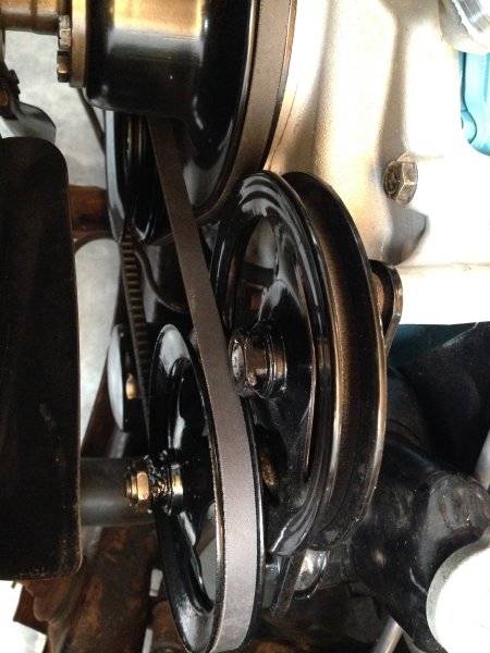

That's good to know, but in my case, I have "used" original fan and crank pulleys, but the PS belt rubs on the fan pulley. I went through my stash and found a seemingly identical PS pulley, but it uses a narrower belt (15 vs 17 I think). It gave me just enough clearance to not rub (still very close though).
After 50+ years, the original pulleys could've been replaced and they don't have part numbers on them, so how can you tell if they're 69-71?
Pic shows the narrow pulley installed and wider pulley resting on top for comparison.
That's good to know, but in my case, I have "used" original fan and crank pulleys, but the PS belt rubs on the fan pulley. I went trough my stash and found a seemingly identical PS pulley, but it uses a narrower belt (15 vs 17 I think). It gave me just enough clearance to not rub (still very close though).
The rub on the water pump pulley is perfectly normal. Do not worry about it.
