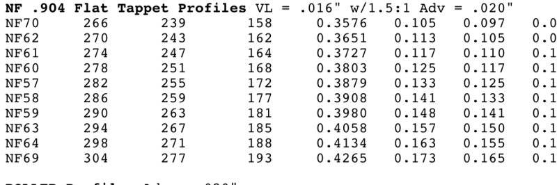

Check out Bullet racing cams SFT tight lash solid lifter Mopar grinds. Talk to Tim Goolsby.

As mentioned have the heads flowed, at your engines level cylinder head flow will make all the difference in the world. I would use a camshaft with a tighter center line. Generally, with a flow limited head you want to open the intake valve sooner, a 108 centerline cam will do that. If you want to get into it buy an engine simulation program, I like performance trends, the info in the manual that comes with it is worth the price alone. Plus all the fun you have building engines with out spending money. I have a real engine dyno and use this program to help with specing customers engines, and it is right 99% of the time when they are finished and on a real dyno. It predicts a lot of stuff like idle vacuum, cranking compression, fuel consumption, injector size if using EFI. Another good one is Pipemax, especially if building or buying headers for your combo.
I bought the CNC ported Stealths. Flow with my Isky 292 cam is 278 at .500 lift, 242@050. Don’t know where that would land on your combo. Mine were 2600 to my door with the upgraded springs, retainers and 7 degree locks.
