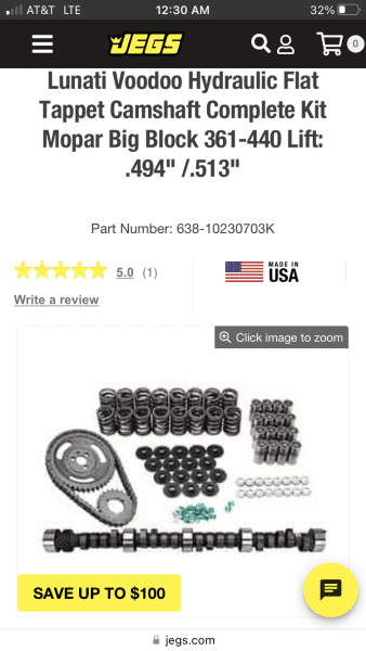

I had another question about the Lunatic 703, with it being 494/513 lift, I need to change most of the valve train and they sell the kit with the necce

If im gonna upgrade basically the entire valve train to handle the 494/513 lift of this cam, they sell this kit with the necessary springs and keepers etc.
would it be better to just also buy whats missing from this to replace rest of valve train, or should i just get the cam and lifters and pick my own replacement valve train?

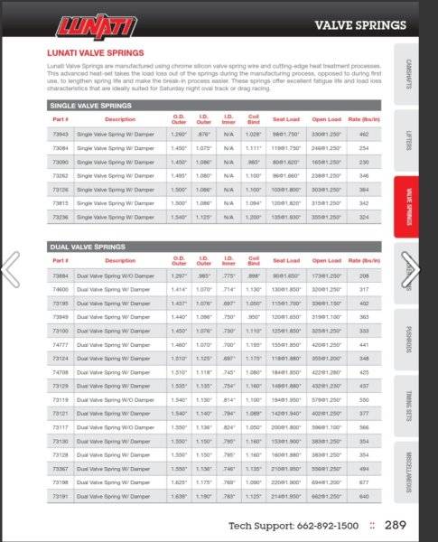

Older catolog page but Lunati recommends spring part 73100. 125lbs @1.85. 333 lb spring rate. It's a bit fuzzy...zoom in. LOL
It's a dual spring. You have to cut the guide and update the seal to run these. There are single springs out there as well. Dual spring you can brake it in wo the inner spring installed which is nice if it's what you considering. I would call it optional this cam isn't that big nor are the springs. But It's never a bad plan.
73815 is the spring they recommend in the current book. It's a single w damper.
