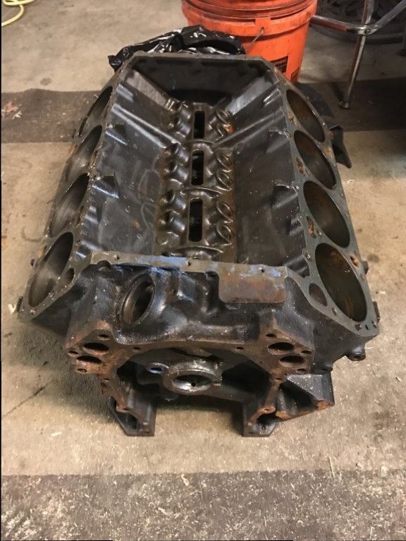

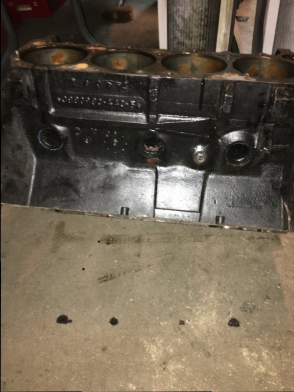

Looks great, nice score! Does it have the raised bands along the sides just above the freeze plugs?

Little update for everyone, dropped the block at the machine shop this morning for a once over. Decided to buy a stroker kit for this seeing as I need crank pistons and rods anyway.
View attachment 384581 Little update for everyone, dropped the block at the machine shop this morning for a once over. Decided to buy a stroker kit for this seeing as I need crank pistons and rods anyway.
And..how much does that cost? What will be the CU inchs and HP/Torque numbers?
Ehh I'm guesstimating around 6-7 grand to build the whole motor. Displacement will be either 494/496 depending what bore I go with, waiting on word from the machine shop. Just going off similar builds I would say 600+ horse close to 700 torque.
Hey guys, just an update on my block, everything checked out fine at the machine shop. Got the green light to start the 505 stroker build. That's an update also I think last time I said it was going to be a 494 stroker, decided to go with the 505 kit instead.
Thanks for the update, sounds righteous.
