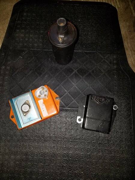

I have since pulled the Volt Reg and ECU out to install new ones when they arrive. Does that terminate all the tests I just did? :(
That must be with the original ECU still connected?
No I had it out. Its ALL out now. New parts tomorrow

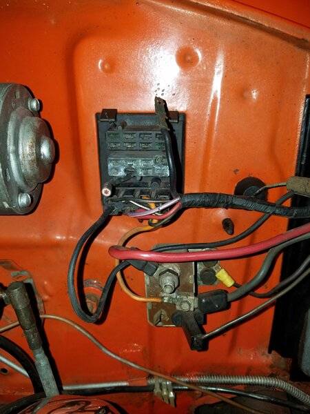

I had 1.5V at coil + with key on before ALL wiring was yanked. I have dash harness and engine harnesses and almost every wire from front seats to alternator out. Luckily I've been thru this a few times. Someone really hacked it up, usual Ammeter/Alternator lead was long gone, circuit board had home grown repairs, (lol), of course my father really only drove it 1/4 mile at a time.
Most of what I found were things Ive done myself when I was 18 and owned a 73 Rallye Challenger 340 car. Tail lights "Jumped" to the wiper switch + wire etc, etc.. Pretty butchered up! Of course in 1988 there wasn't a Year One (That I knew of). Some of the pics I have are really worth at least 100 words..

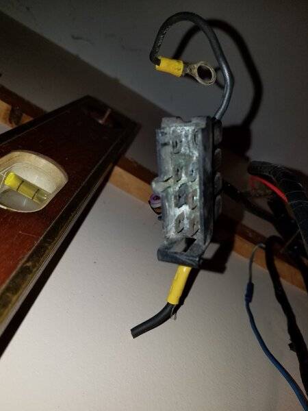

The "Crap" on the floorboard didnt even belong in the dash.
