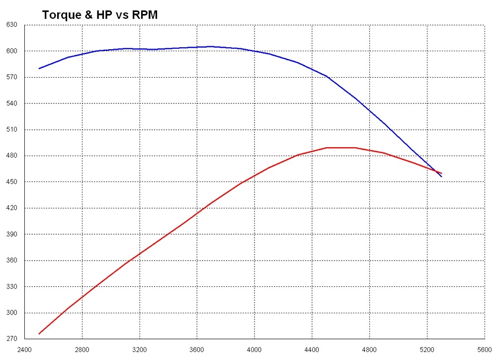

440-6, stealth heads (stock except for upgraded retainers/locks), 10.5:1 CR, Lunati 60303, SRP flat tops, SCAT H beam rods, 480HP @ 5Krpm. Heads checked out perfect with machine shop (always do this). Love the stock look.
Running on the test stand...
sImpressive! Checked good right out of the box except for locks and retainers. I was beginning to believe it couldn't happen. Thanks!!!
