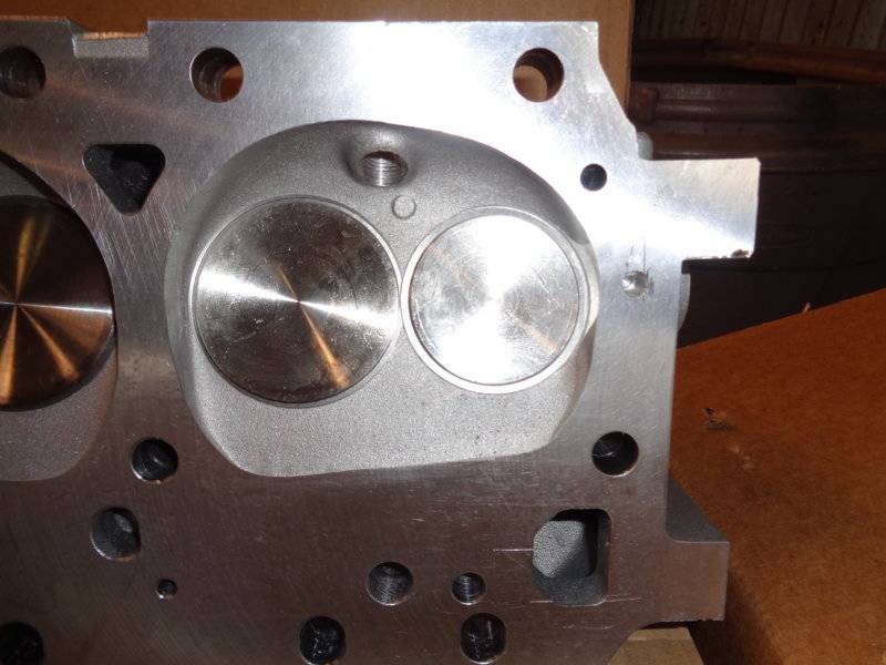

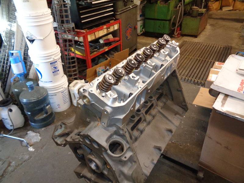

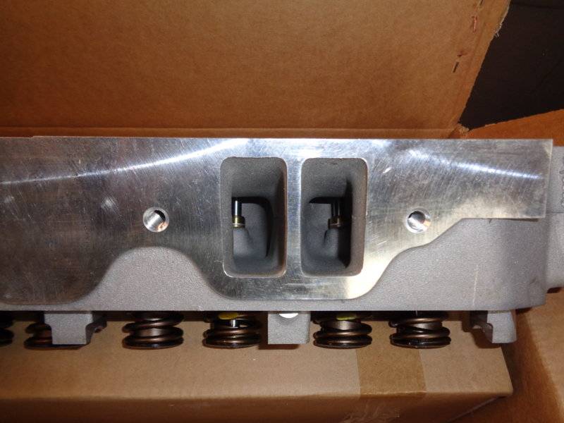

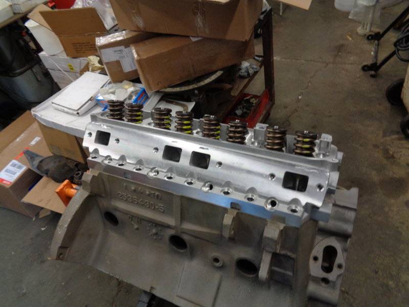

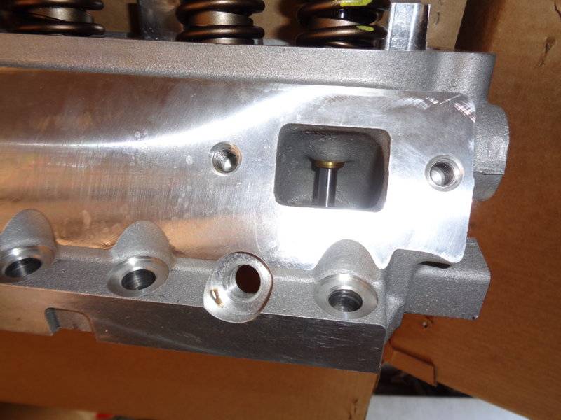

i just recieved my stage 2's from 440 source . they set up the springs i needed for my cam specs . the quality looks
great . i'm do to disassemble them to check them out . but i thing i won't even have to port them for this build . thumbs up on these strealth replacement heads .

i just recieved my stage 2's from 440 source . they set up the springs i needed for my cam specs . the quality looksView attachment 580160 View attachment 580162 View attachment 580163 View attachment 580166 View attachment 580167 great . i'm do to disassemble them to check them out . but i thing i won't even have to port them for this build . thumbs up on these strealth replacement heads .
What is the Stage 2?
I have a set of Stealths on my 440 and for the money they are great. I did replace the springs and locks due to my cam but they were very nice out of the box. I cleaned up the pockets and casting and that was it. For me it was a matter of money. I would have loved to get the TFs but at twice the cost I figured these will fit the bill as I wasn't planning anything above and beyond 500 h.p.
stage 1's were , now its stage 2's . some improvements to port ramping . they use longer valves then stock . i'm doing a custom ground hyd roller , so i had the cam grinder just with them for the best package . after all they work together , with the intake we pick out . its all in at 5500 . its all going in a 70 dart project as a driver . should be a fun car , lol .

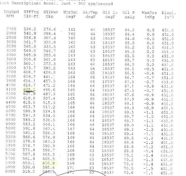

I got TF240 from 440 source and let me tell you that I got better than 1st class service from Kim and Brandon. Buy from them. They helped throughout the purchase. I had a set of 440 source and they were great. I then got a set of TF to put onto my 451 and they were better performing heads but at the same time more than double the price when you factored in the pushrods, bolts , header mods needed. 451 pump gas 10.75 comp eddy perf intake and a comp XL285 cam. Just past 600hp and 625TQ very nice street motor. I could imagine if I did a 470 or even a 512. It would be killer on the street and track. Good luck on your purchase
Forgot to include Dyno sheet:
