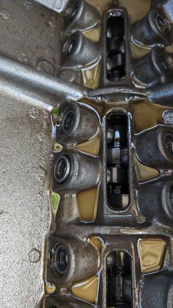

Took this picture recently, piston 4 intake lifter is on the left here on its way up. I think I can see the retainer but I'm not sure. What do you think?

What brand & part number are the lifters?
The reason I ask is because they look to be the ones with the thin spring steel clip as the retainer.
I’ve seen a few instances where those got damaged during some valve float and a pushrod danced around and “stepped on” the retainer.
Then it folded up and popped out of the groove and was floating around on top of the lifter.
One instance was on a Pontiac, where more than 1/2 were like that.
It was still running fine, and was discovered when the valley plate was removed to cure an oil leak.
You might even be able to see it by looking down the pushrod hole, or looking in the distributor hole.

They're def within 1/16" (.0625") but there's too much movement and no great reference to measure from so I can't confidently be any more precise than that. Everything up tops alum too so my magnetic base is useless...

I wasn’t referring to the wire clips, I was referring the these, which are designed to preload the plunger some.
In the Hylift-Johnson world, these would be used in lifters that have the “R” suffix.

The circlip shown in post #16 is a beefed up design that allows the lifter pre-load to be set for minimum lifter pump up. The strong design will contain the prod cup in the case of lifterr puimp up, where the paper clip design will punch out. That is the theory....
