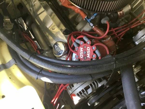

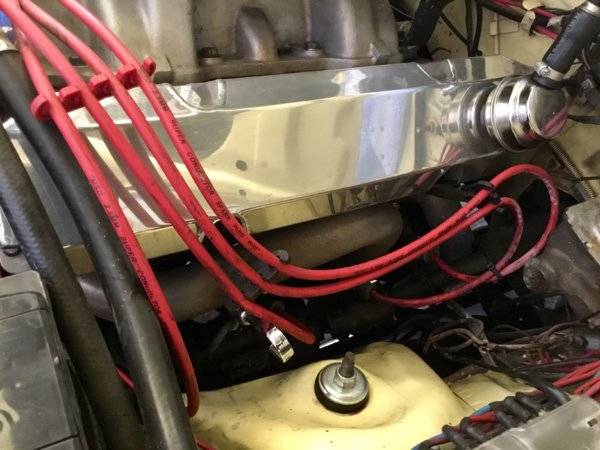

Guess I'm a little late to the game, but here's mine... using the Accell 9000's, we routed 5&7 around back and used the 45* on 8, though #6 works as well. Maybe a little OCD, but I use like 2 sets of looms so at no point do the wires touch anything.

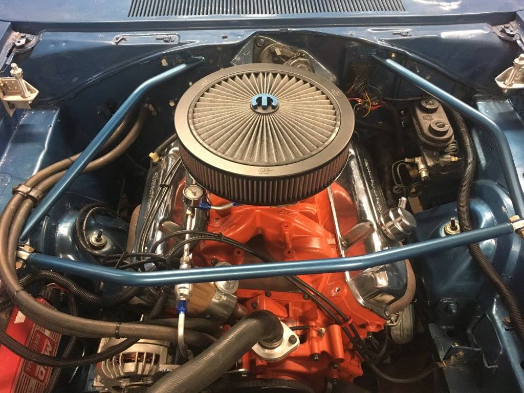

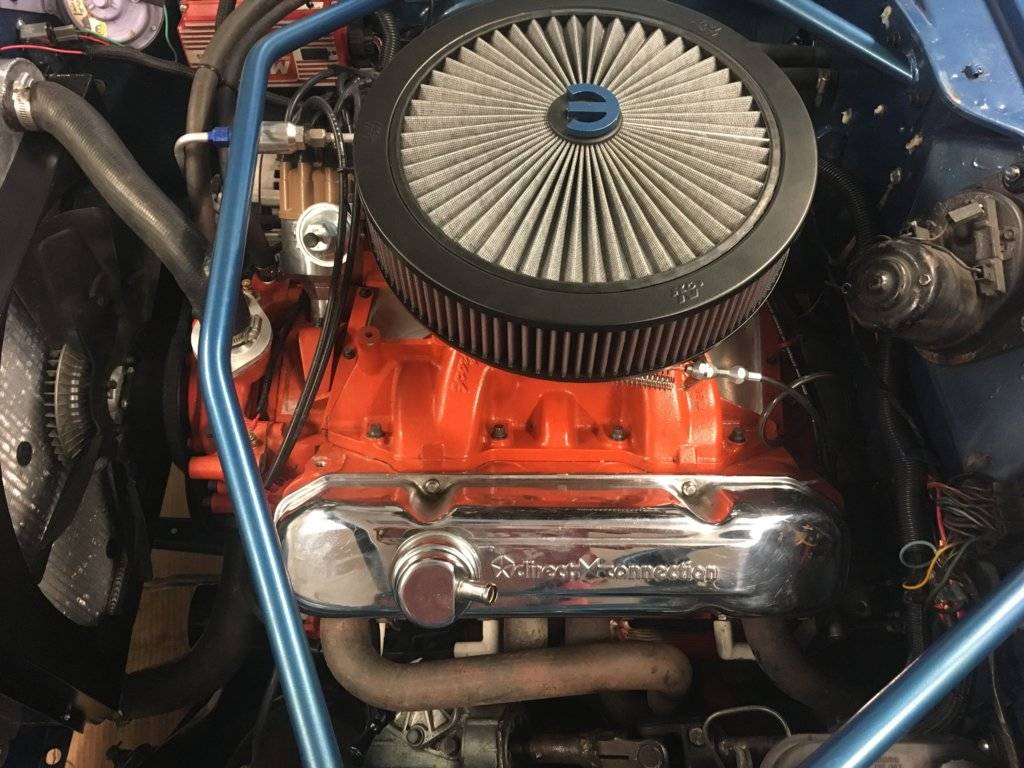

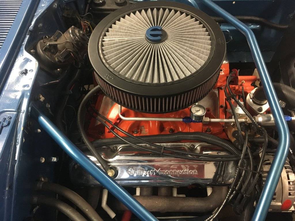

Dang, I wish this site would alert me when someone has posted on a thread I started!!
Thanks for posting, I do appreciate it and I DO like the idea of running #5 & #7 around back of the carb like that. That's damn near ingenious!
You know, I still haven't used the looms yet, been procrastinating on the spark plug wires. I got sidetracked on installing the radio in the dash and all that (still haven't found an antenna that works with my bizarro 1/2" hole in the fender).
Think I'll tackle the plug wires this week, though.
I'm very concerned with fetching MSD's, can't seem to figure out which ones have the terminal ends for a Mopar dizzy cap AND are extra long so I can custom trim them??
Thinking Accel and those lovely ceramic ends might be the better deal.

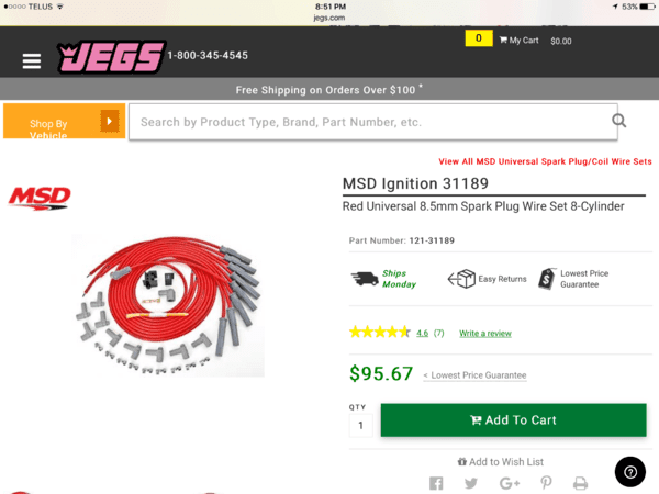

That's funny, I have a set of MSD adjustable plug boot, 8.5 on my 440/505, cut to fit .
The key word on those like the Bob before you posted is "universal", Bob....and the ones he cited fit the MSD male post type distributor caps, not the factory female "socket" type cap like I have.
MSD does not make an application-specific 8.5mm set of these wires specifically for the factory style distributors with customizable (read: cut to fit) length wires. I spent time on the phone with Summit to see if they could find anything, but nope.
However, they do make these if I want to roll the dice on a "universal" set having long enough wires in it:
https://www.summitracing.com/parts/msd-31199
