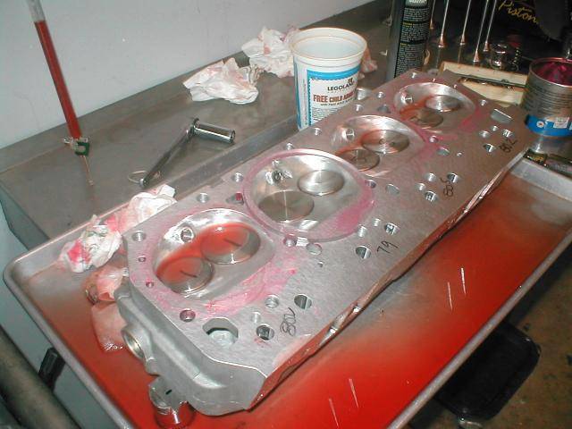

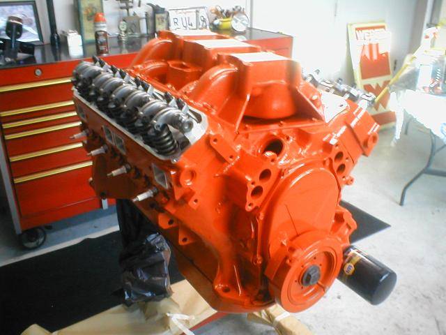

I chose the stealths on my 505ci to keep the OE look. the only major thing I did was even the cc volume on all the combustion chambers since there was just a little over 3cc's difference from the smallest to the biggest. also new spring and retainers, mild porting and nice valve job.
