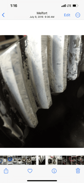

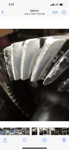

Here is the next to final pattern on my D60. It still needed.010 thicker pinion shim to get it into the middle where I wanted it. Sorry I don’t have pics when we got it done. Somehow deleted those pics. Kim
