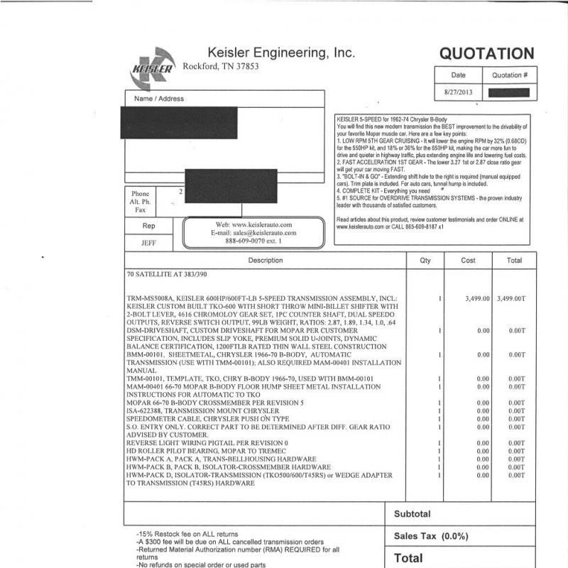

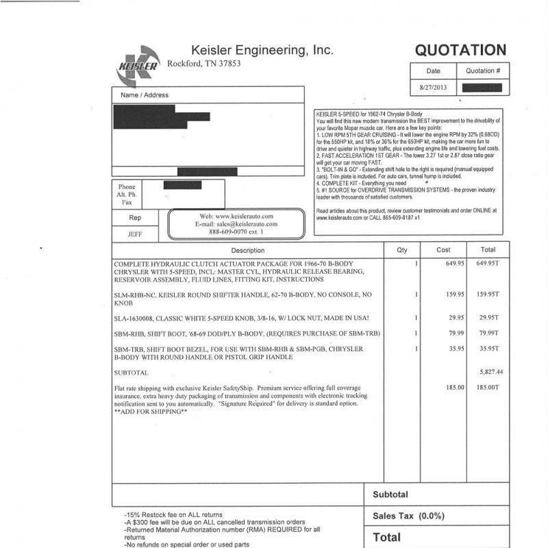

I got a a quote from Keisler which seems pretty high. I just picked up a 1970 satellite with a automatic column shifter and was thinking about putting a 5 speed in it. But after this quote i will be rethinking this because of how expensive this is.
Does anyone know why? Or is there anyway i can get a cheaper 5 speed or is this on the money for what i am trying to do? $6K seems

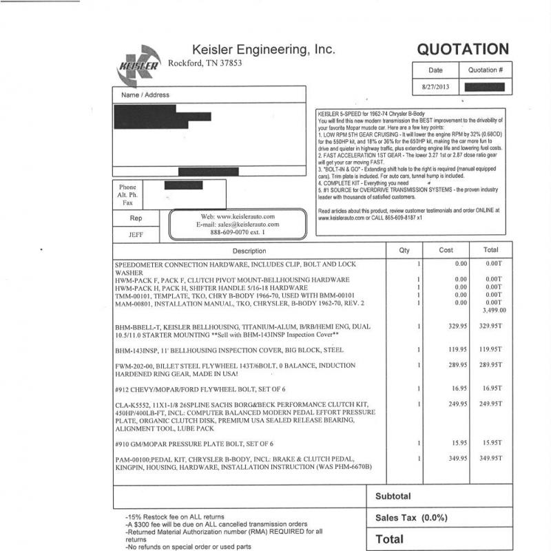

Well from a quick read through the quote that is literally every-thing or pretty damn close to it. You are going from an auto/column car to a full manual trans and need everything it looks like. If you get it all from them it's gonna cost more than going from a 4 speed to a 5 speed in an existing manual car. You even have hydraulic clutch set-up sourced there at $629, plus pedals, flywheel, flywheel bolts, clutch, shifter, shifter ball, shifter ball nut, shifter boot, shifter boot chrome hold down, and on and on, literally everything including many parts you would be replacing in the resto if you had a 4 speed car and were just restoring it as is.
If a 4 speed guy were just replacing all his 4 speed stuff that typically needs done on this list it would be pushing $1.5-$2K so it's not really that bad when you think of it that way. And the manual trans experience if you keep it is gonna be priceless. So you could look at it that way or like you said, sell this car and buy one that's already a 4 speed but needing most stuff refurbed and speed a good deal of money too and still have a 4 speed car. Of course having an actual 4 speed car is a plus and you could have fun with that while you are thinking about spending $4K to upgrade to a 5 speed.

What is your problem? You want it, YOU will have to pay for it. The quote I read includes a hydraylic clutch setup and a pedal kit. Those two items alone add over $1100 to the cost. Try finding all of these pieces at swap meets or online and you may save a few bucks. By buying a KIT, you are paying MORE for the convenience of having the VENDOR do all of the parts collecting.
If you want junkyard prices, go grab your tools and get to it. You can buy a B or E body 833 4 speed and use ALL factory parts to get it into the Plymouth. If it is an overdrive you want, Brewers sells a replacement gear set that fits inside the stock 4 speed case, but it has an overdriven 4th gear. It costs about $1900 for the gear kit.
No matter how you look at it, it is the OVERdrive that makes these conversions expensive. If you have average luck in scrounging, you could gather all the individual parts to swap in a stock 4 speed for less that $2000.
