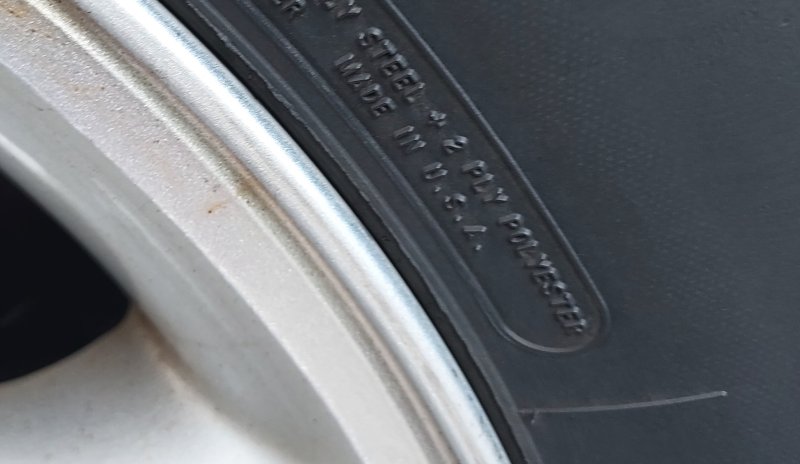

Ok, maybe I got it right this time. 0319 and that should be March of 2019 which means the tires were somewhat “fresh” when I got them. Really unfortunate for them because now they will lose my support and I will search out different brands and go from there.
I hope this helps anyone else here who may be considering buying tires. I can assume that most of us generally only drive our classic cars in better weather and like me replacing tires more based on aging out rather than wearing them out. All I ask is to get around 10 years of reasonable service without falling apart.
According to what I have read in researching my own tire codes, the 03 of 0319 is one of 52 numbers of the first two digits, meaning these tires were not made in March, but rather the 3rd week of 2019, so they're January tires.
Well at least they were made the same year so I guess that’s a good thing. I have learned more about tire dates and since my plan is to replace based on age rather than mileage I will be reading tire dates on replacement tires.
