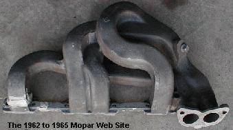

Even the old heavy *** cast iron S/S & Ramcharger
413/426 wedge style exhaust manifolds
were really good exhaust scavenging manifolds,
headers build similar would work extremely well,
albeit they are extremely heavy, copy them with tubing
& it'd be great

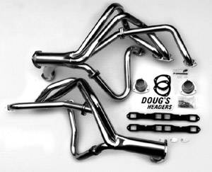

or fender well style headers, like the ol' 383-440 style

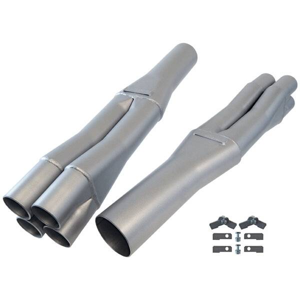

scavenging style 4-2-1 collectors help too
albeit a tad heavier that atypical 4-1 collector
even the 3" scav. 4-2-1 flow better
than the 3-1/2" 4-1 style
