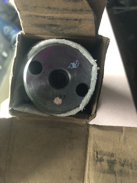

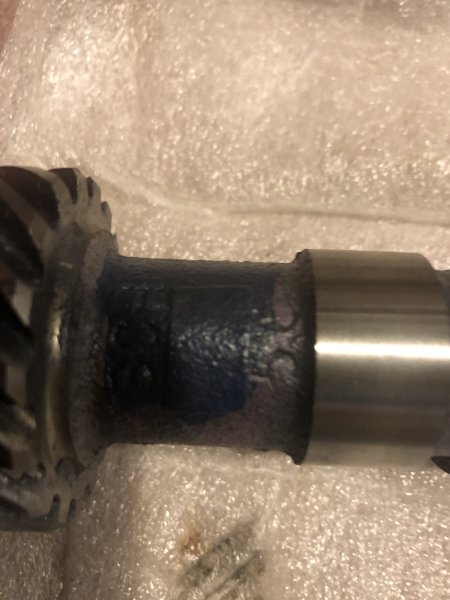

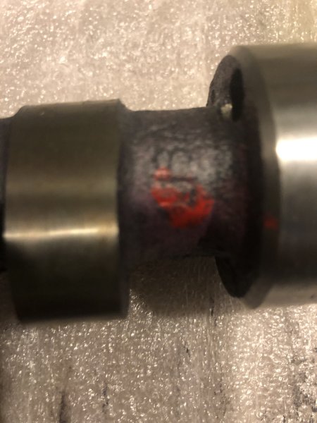

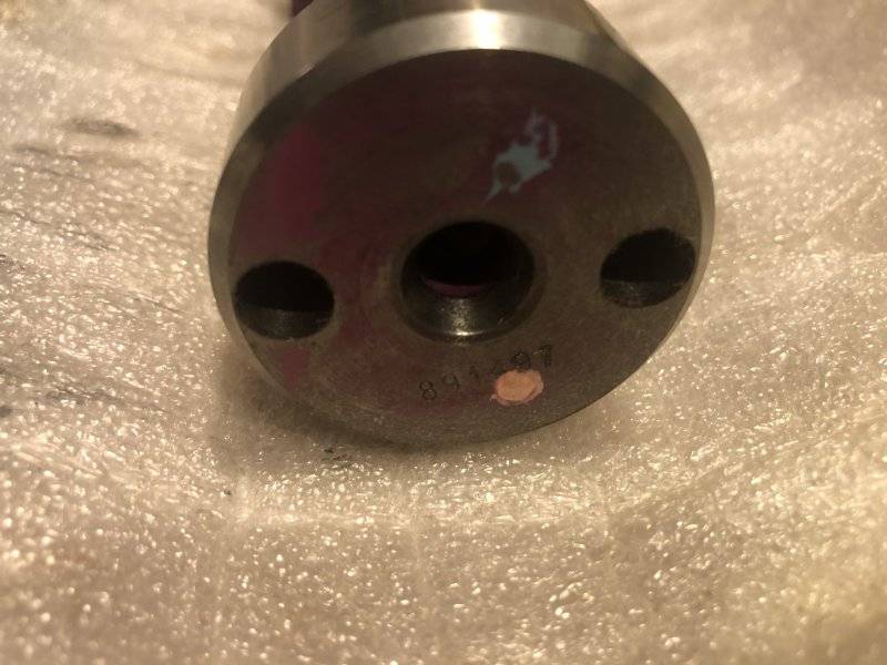

I need help I’d’ ing this cam I bought it new in the box 30 years ago only #’s are on the cam gear face 891497
I’ll enclose pictures as well thanks for the help. I believe it’s 108* LSA
Back then Racer Brown was most likely the cam grinder. Someone might have some information on them.
It says 509 on the box. So probably the 292/292 adv duration cam with 0.509" lift, 108 LSA.
248/248 @ 050.
