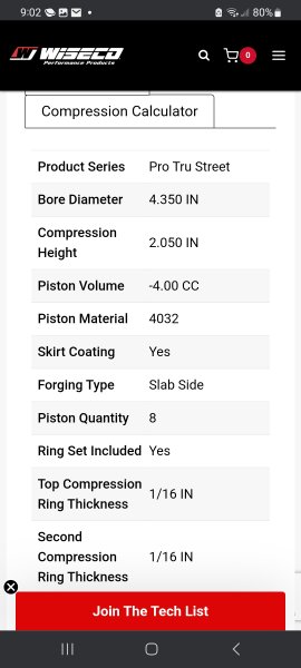

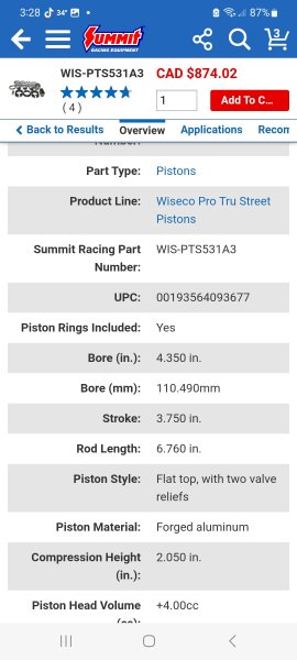

Well I thought so too according to summit..but would appear they're wrong. I would trust wiseco spwcs first I think..
I have run into this before with Ross Pistons and BSB67 is correct, you have it backwards. Aftermarket manufacturers call it -4.00cc, but what they mean that 4cc is added to the volume, NOT subtracted from it. I told the tech guy at Ross that it must be that new math that they teach! Look at the "Flat" top of the piston, and then look at the divot in the top of the piston. The ONLY outcome is that volume is added. The only way a hole will result in a subtraction is when a step or dome of some sort is on top of the piston like KB pistons do.
The formula he is using itself tells you what sign to use for dome verses dish. Obviously the valve pockets would represent like a dish in the calculation.
Yes...Ty explained it to me. I was reversing the CC value..I feel so dumb. Guess should have read the instructions in the Calc...lol.
Thanks guys

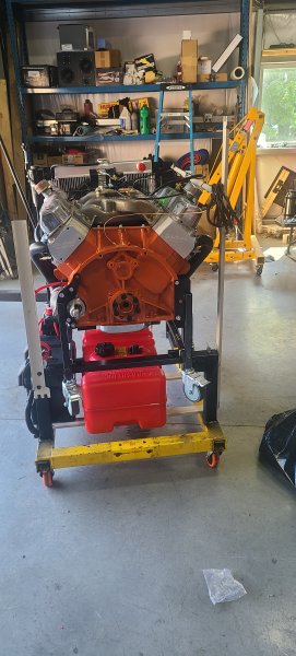

Just received the rotating assembly from the balancing shop. Now the assemble.

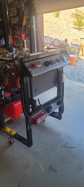

Will keep posted as run stand is now complete. Just waiting for 1.6 rockers, measure push rods and start up. Trying for end of next week...see how she goes

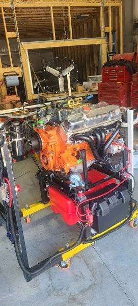

I've got the engine back together getting ready to do a breakin. Rotating assembly was balanced and new cam all lubed up. Just finalizing the details. But have a new problem.
I purchased a starter plate from the fellow on ebay. Fabbed it to a allstar engine cradle. Worked well for the GTX 440 to check that one out. Had bad stamped rockers, so replaced with rollers and push rods from Smith Bros. Lifter noise gone and runs good.

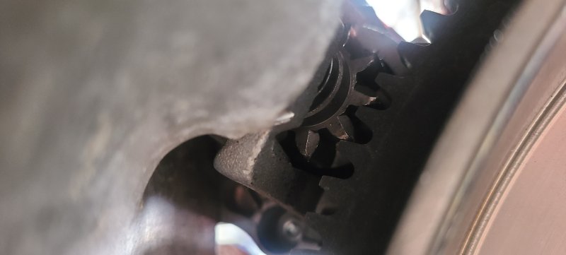

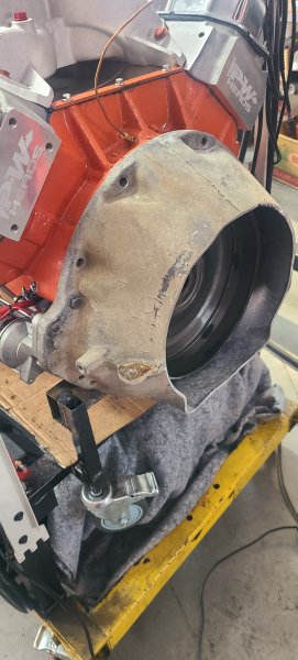

So now the problem 440 that's been rebuilt back on. But the starter now binds on the ring gear? I've played with this for 2 days now. Finally cut off part of a 727 housing to make a BH and using a flywheel instead of a half TC. And same thing. It just won't release ? What the heck a m i doing wrong?
Anyone else had similar issues and any problem solving?
Some of these mini starters can require a small bit of clearance on the block, look there first. The block can push the starter slighly not letting it seat squarely on the transmission cocking the starter slightly causing it to bind.
If the ebay part is made in china..it may be faulty as well.
Well apparently he makes them himself with CNC. But that's why I did a cut off BH from a 727 case. I think the starter drive is going in too far. I'll run a few thin washers and see what it looks like.
Thing is, I ran this setup on the vehicle before the run stand. And now all of a sudden having issues. I don't get it? No room for movement sideways. Only in and out.
This^^^^
GOT IT! These starters have a larger hole on top causing alot of movement. I put the stud on top instead of bottom, little tweaking and were golden. But i did ditch the starter plate for a BH setup. After a few emails from the ebay fellow, found out he doesnt follow a BH pattern for either BB or SB plates. I suppose it works, but i didnt want to play around anymore. Lines it up for the starter and then cuts. Better with a BH anyway as now I have a ring gear cover. And no guessing for too much alignment.
