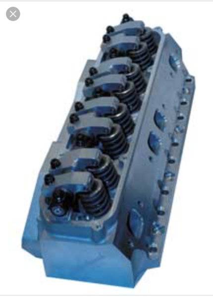

That victor head makes good power, but overall, it’s a huge disappointment. Almost every rocker arm hits on the valve cover. It’s like Edelbrock got 80% done and said “good enough for mopar people” and sent it to market. The whole valve cover rail should have shifted a 1/4” to allow for rocker clearance. You might as well mill the stands off and run a set of T&D or Jesel rockers.

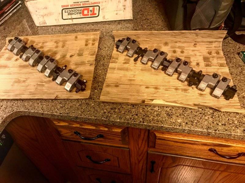

Got a set of t&D for my victor mw’s

I have a set of victor knock offs, they are very well made, no porosity, and copy the victors very closely, standard port "cnc" versions that flow 352 at .600 , but don't go up much from there. I run hughs rockers and "none" of them hit my mopar perf. valve covers ! We did change the retainers and keepers tho, springs tested good. I run a fast 2.0 f. inj. set up w/ their dist. controlling the timing. The FAST dist. is based on a short chevy type dist. , and took an extreme amount of grinding and cutting the front of drivers side head to get it to clear, other than that, I`m happy w/ them so far. They only weighed 6 pounds liter than apiece than a pair of 915`s I sold. They are extremely tite in an A body fastback tho, can just run my figures between the head and firewall. ( inside hotrod heater under the dash), no room for heater blower motor at all. Would be better in a B body for sure. Haven`t made it to the dragstrip yet, the engine is just now getting broke in , car will turn sideways very easy tho.

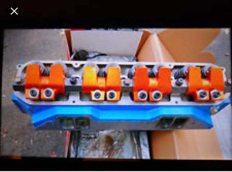

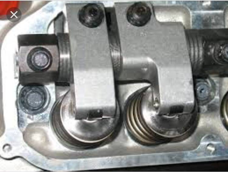

Let me get this straight.. you’re calling what I said, which is based on my experience with about a half dozen different engines built with genuine Edelbrock Victor heads and various different brands of rocker arms, the worst combo being bulky Harland Sharp rockers, bullshit because of your experience with a copycat head and a brand of rocker arms that I never mentioned? Lol here are a few pictures to illustrate the problem. Not my pics, just grabbed them off the web. You can clearly see how tight the rockers are to the valve cover rail. The worst being the Harland Sharps. Try putting a cast valve cover on that.... if Edelbrock had shifted the valve cover rail up towards the intake by a 1/4”, you’d have all kinds of clearance, even for HS rockers. Just because you don’t like what I said doesn’t mean it’s bullshit.

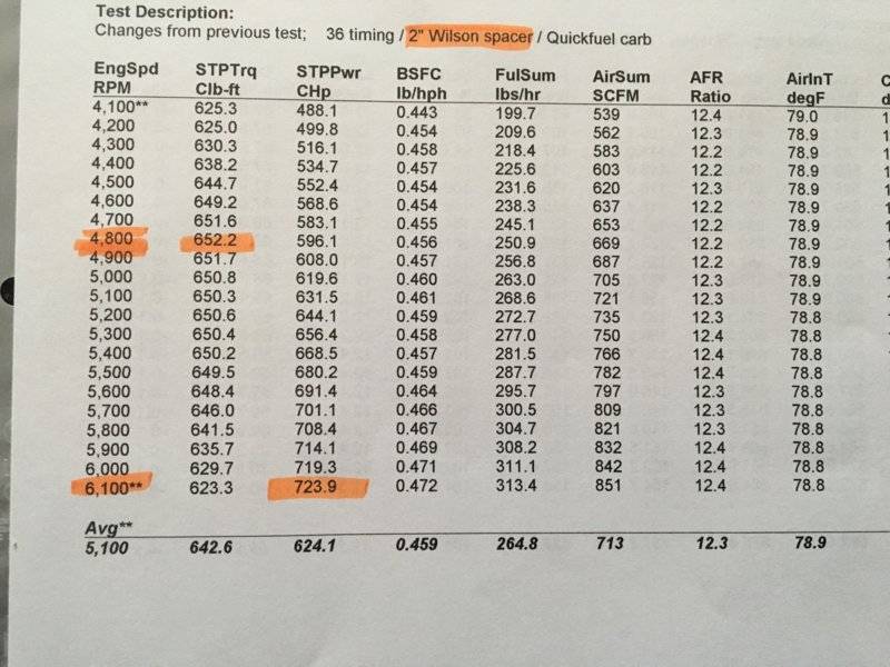

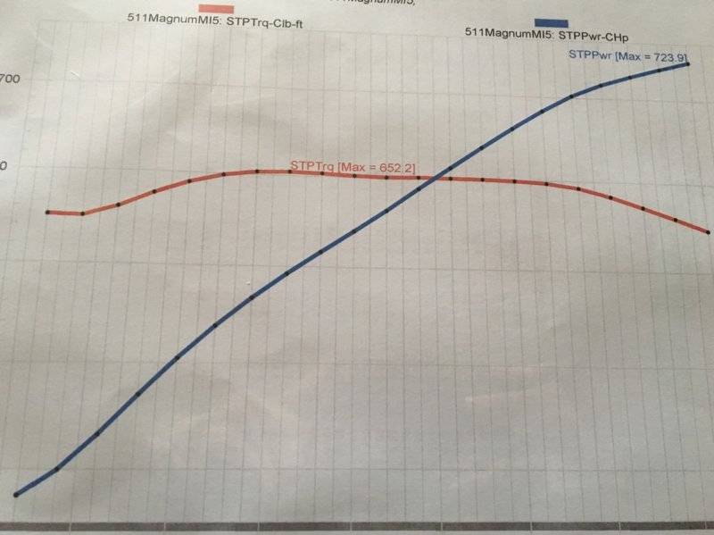

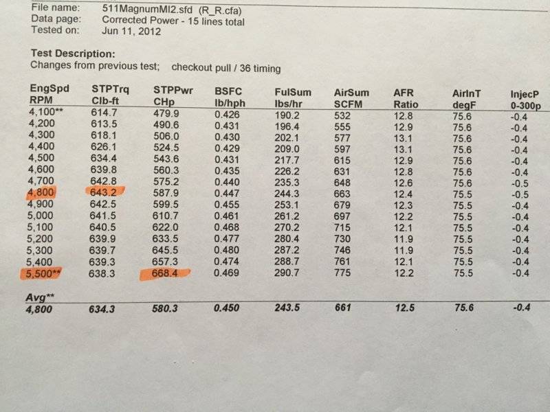

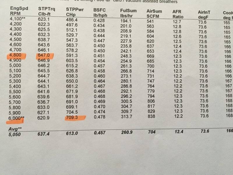

So this Happened today... will post video to my YouTube Channel. Had a leak at the front of the oil pan/ bottom of the timing cover? Sooo that will be fixed. Otherwise made 4 pulls. They adjusted the timing from 36 to 34 once which dropped a couple Hp so stayed at 36. The Wilson spacer gave the best number for the day.
This is “corrected power” data. I’ll share the other data if it is preferred. I don’t know the proper Dyno etiquette.
The numbers are COOL, but I was glad the “Mystery Mudder” turned out well. To be honest it’s more than I really wanted... and I have mixed feelings about it. I have a Cope Pro Street rmv transmission and we are building a Dana. But a long ways to go yet
It started perfectly, no issues breaking in. The Quick Fuel carburetor was literally “out of the box” barely needing adjustment.
We used 91 octane with less than 10% Race gas, but looks like it can live on 93 octane. Which would be cool.
I’ll find the cam card and give details adout the build in the next post from me on this thread.
I’m sharing this for guys looking at Trick Flow 270s. I am not a mechanic or engine builder. So this is as much as I know for now.
Thanks

Nice #'s congrats

Great numbers, I have never seen that cam before. Comp doesnt have any info on the website for it do you have the cam card? TF PP270 and this big solid looks like a winning combination. Street driving it would be interesting.
Like hemirunner mentioned that motor would probably top out at 775hp or so the way it is pulling at 6k assuming it gets enough air. Congrats.

Really not calling u a liar, but ur experiances (probably more than mine) w/ victor type heads ain`t he whole story, I don`t have a problem w/ them, a went w/ the best bang for the buck when I bought the heads. I do think the hughs rockers probably have more clearance than most of the others. I had a set of proform to start w/, and they had 4 rockers that are notched in the upper corners for that reason, I didn`t notice them and didn`t put them on the ends, and they hit , but didn`t when I switched them.
