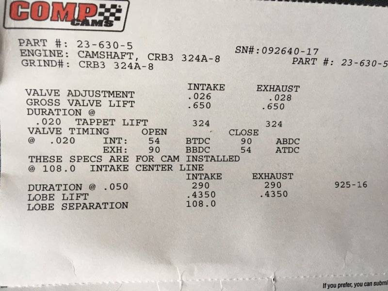

Great numbers, I have never seen that cam before. Comp doesnt have any info on the website for it do you have the cam card? TF PP270 and this big solid looks like a winning combination. Street driving it would be interesting.
Like hemirunner mentioned that motor would probably top out at 775hp or so the way it is pulling at 6k assuming it gets enough air. Congrats.
I’ll post the cam card when I get home. Gary said he has used it in quite a few other builds and really liked the results he got with it.

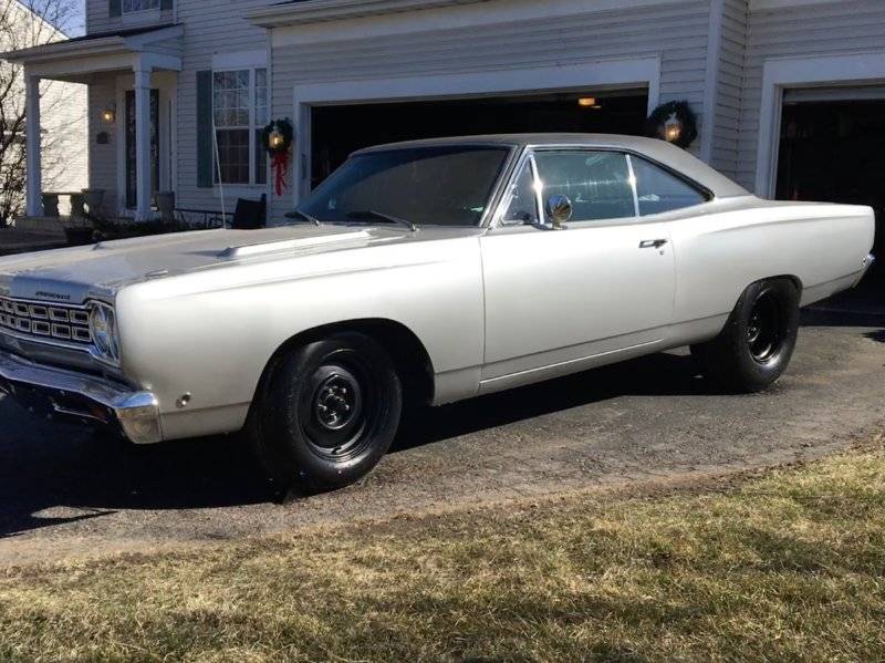

Next we will relocate springs inboard, mini tub, and Subframe connectors, possibly torque boxes too... building a custom width Dana as well. Think I’m gonna need a roll bar, a lift off 6 pack hood, and...fuel system, better brakes. Good lord where will it end!

I’ve never raced at a track before, had a 350-400hp GTO as the fastest car I’ve had. Going to take it slow and learn how to do this right, but I’m sure the day for this information will be coming. Thanks
Bigfoot, is this going in a street car or drag car? What fuel are you going to be running? Make sure to play it really safe on the street in the beginning, definitely invest in a Wideband 02 setup if you haven't already!
