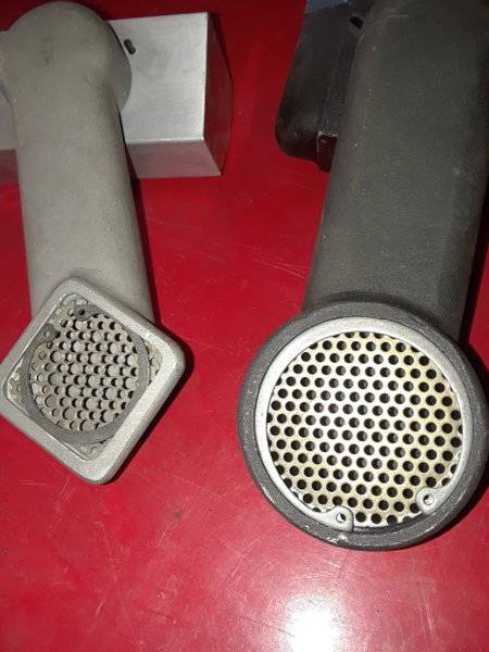

Dont mean to be a busybody, but if I can remind you. The restriction on the inlet side of the external line setup is the inlet screen of the swinging pickup. Remove it. Thats if you have the swinging pickup of course. The static pickups will pull air at a higher oil level than a swinging pickup.
Dont mean to be a busybody, but if I can remind you. The restriction on the inlet side of the external line setup is the inlet screen of the swinging pickup. Remove it. Thats if you have the swinging pickup of course. The static pickups will pull air at a higher oil level than a swinging pickup.View attachment 725814
Are you saying to remove the pictured "screens"? I wouldn't. Even with the screens you can pull some pretty good size chunks into the pump. But at least it won't lock the pump and shear the drive . Never had a starvation issue even with the single line pump.

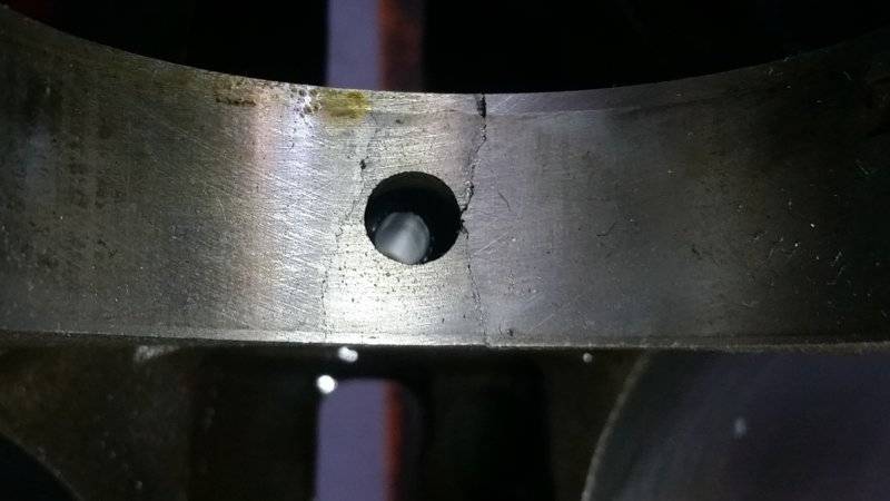

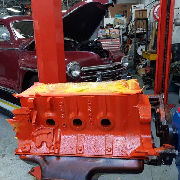

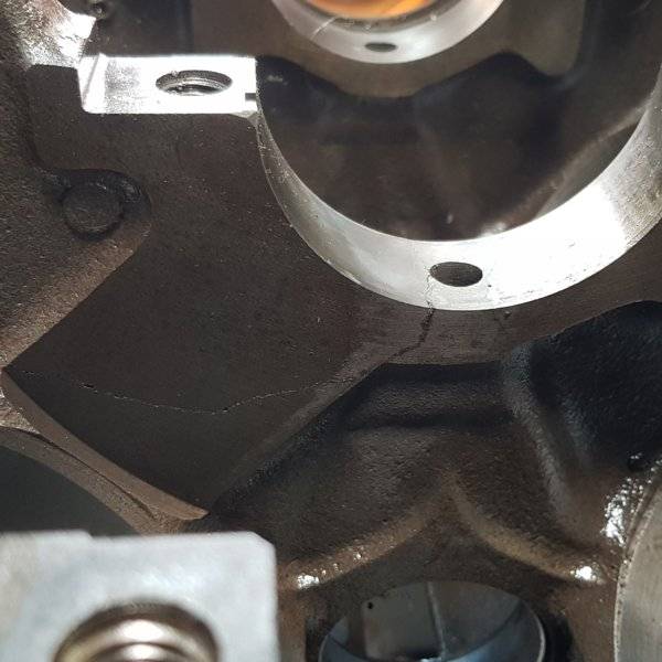

Just bought my new World iron block home yesterday . Nice to not have to deal with 40 + year old blocks anymore .
Old block was worse for wear .

Wookie ,
Tex
View attachment 727200 View attachment 727204 View attachment 727207

Yeah that is scary Tex. You were lucky.
Make a coffee table out of it.
