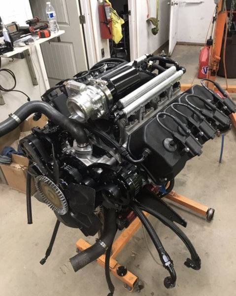

541 street strip motor, TF 270 heads, Weiand P3690982 cross ram or???

Yep, dry flow direct port injection.
