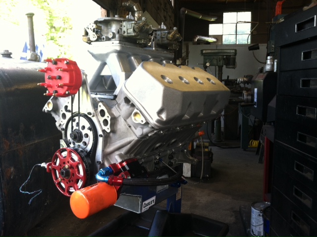

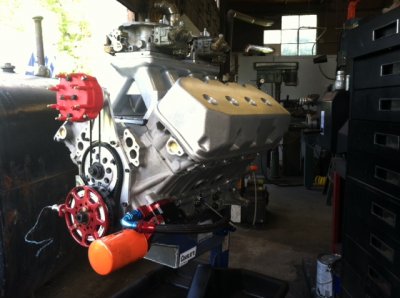

604hemi2.jpg 604hemi4.jpg 10732625_10204905551909146_1767520527_o.jpg NEW HEMI2.jpg
We just got a pair of B1 originals in the shop that someone else has already "ported". Now we get to try to "fix" them. Here are the as received flows from our bench. 2.30" intake. Was shocked as to how heavy these B1 heads are, have a lot of aluminum in them.
.100.................75
.200...............152
.300...............214
.400...............264
.500...............309
.600...............360
.700...............383
.800...............372
.900...............362
TheGodfather
