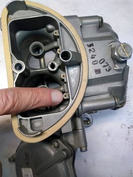

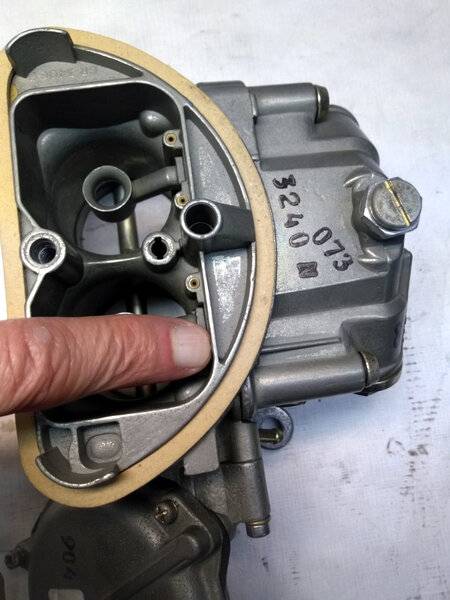

Get it running and as close to idle as you can get. I'm pointing at the idle air bleeds (outers only). One at a time put your finger over the idle bleed , both sides, all 3 carbs and tell us what it does to the idle for each one - stays the same, idle increase, idle decreases. Gains RPM - too lean, loses RPM - too rich.
Maybe we can narrow it down when we get this feedback.
Andy
View attachment 1241634 View attachment 1241636
Thanks, I'll do this once i can get it to idle! Right now it dies as soon as i let go of the throttle. Right now I'm over this car!!
