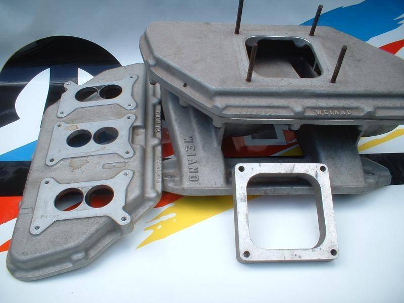

I knew a few guys that used the Weiand manifold, no mods weren't any faster than the stock Edelbrock 6 pack manifold 7 carbs. A couple that used the Mopar combination did OK. But there are a few guys that have different combo's. Maybe check with Biomedtechguy, he's done a lot of investigation.

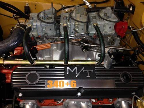

There was an interesting thread about using and modifying cheap corvette tripower carbs for a 440. Search "Tri power carbs on a 440 six barrel"@Sonny
Sonny used some cheap corvette center carbs with accelerator pumps, converted to side hung bowls for clearance, and used a mechanical linkage.
Might just work on that bigass weiand.
There is a local guy around here having good luck running that intake with fuel injected six pack.

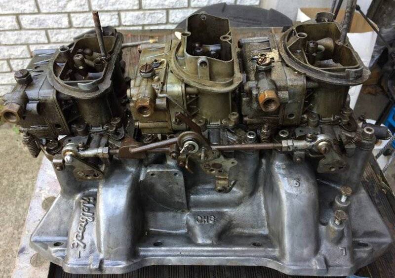

Mechanical numbers are 4782 & 4783 Fuel inlets are on the drivers side.
View attachment 1140153 View attachment 1140155
Wow! that's interesting now all have to do is find them!
