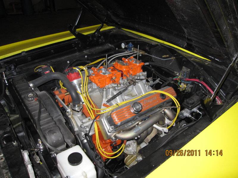

I'm running with the vacuum actuated secondary's and it works great. I have billet metering blocks in all 3 carbs so I can use regular jets in all 3. Tuning takes some time but the results are great!
Mike
wow 493 mike never seen someone paint their carbs. thanks for all the replies.
Powder coat. The original finish was removed by TOO long a dip in my carb cleaner. You learn by mistakes!

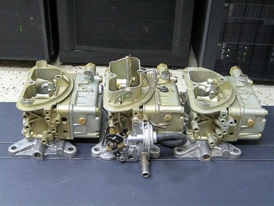

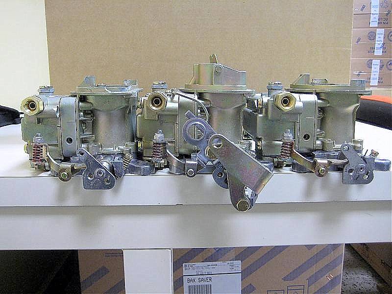

Original mechanical carbs for reference.
Nice pictures
