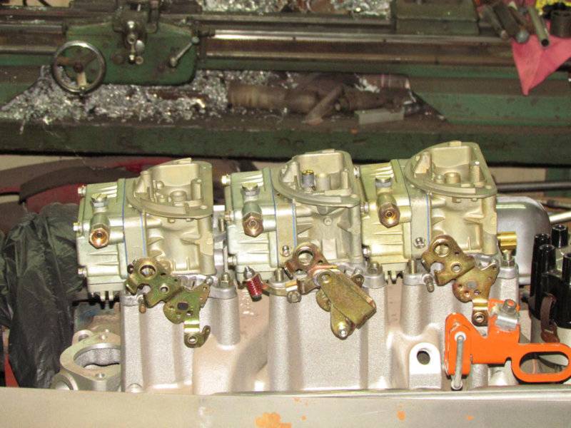

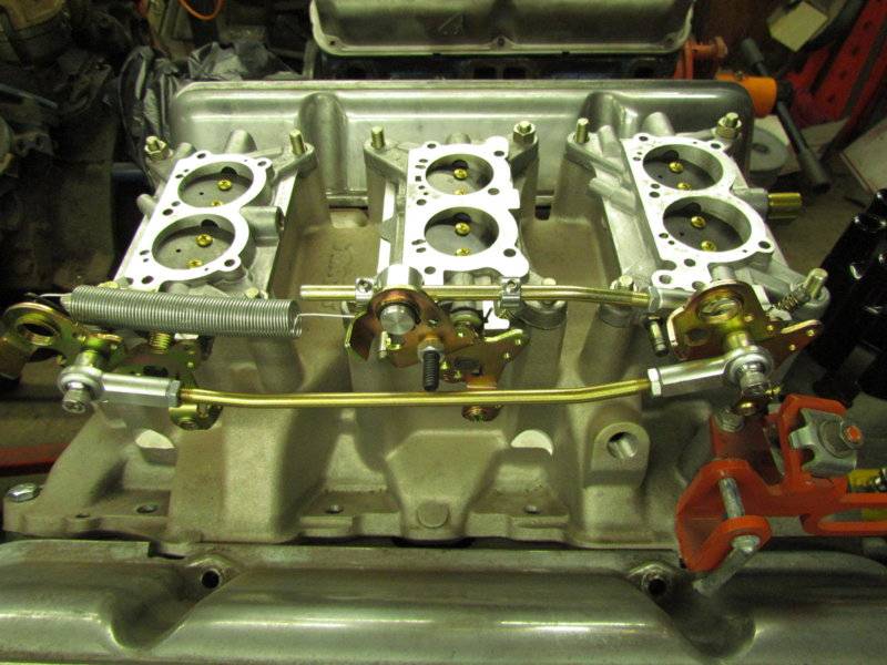

I have this pair I built for the roadrunner. I may put adjustable idle circuits in the outboards depending on how they act. Center is a 4412. I don’t expect them to be any faster than the vacuum carbs, just something different. Plus I plan on going back to a clutch in the near future.

Another member said all the centers are the same. 350 cfm. You have a 500 cfm center, correct?

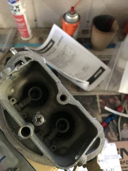

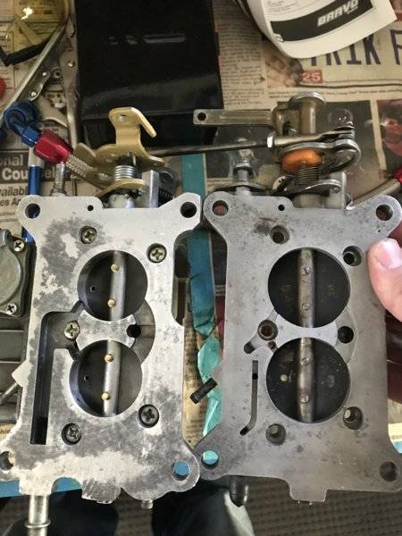

4782 stock center for the mechanical set up is a small 350cfm type carb. I have one from my set, I’ll snap a picture later. Nothing special.
My dad started converting 4412 (500 cfm) 2 barrels years ago for the vacuum centers. That’s what I run on my vacuum set up, I used the same main body and just swapped parts to try it with my mechanicals.

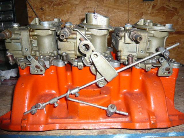

All the centers are 350 cfm,Holley made a 500 cfm carb for many applications but not the Direct Connection set.Here is a set I'm trying to salvage with the correct bases and messed up linkage.

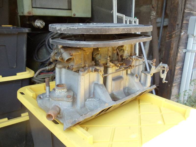

the all mechanical types are fords 406 . note the fuel entree is on the ford fuel pump side of the engine . i've run the set up before . on a 383 , would let the motor rev up there and pull hard . but those are gone . this package is on a rb in a hotrod driver p/u . still building on it . i have another 440 6pck in a challenger r/t . that motor sings to 8k . carrillo rods keep it together . and i have a few more in the wings . i like that set up alot , lol .

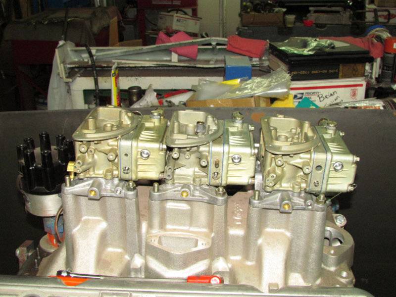

I'm just finishing a set for a guy in Hawaii 7448 350 center and 4412 outer's

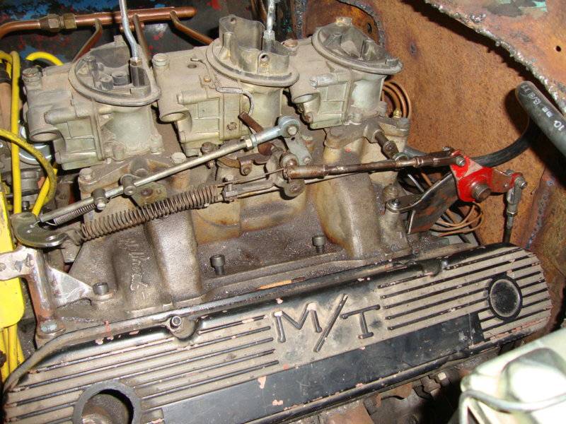

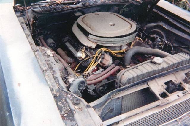

this is what I got with the car was told intake and carbs are correct date for 1970
