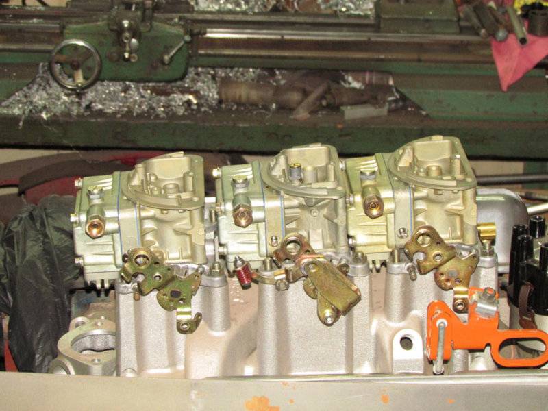

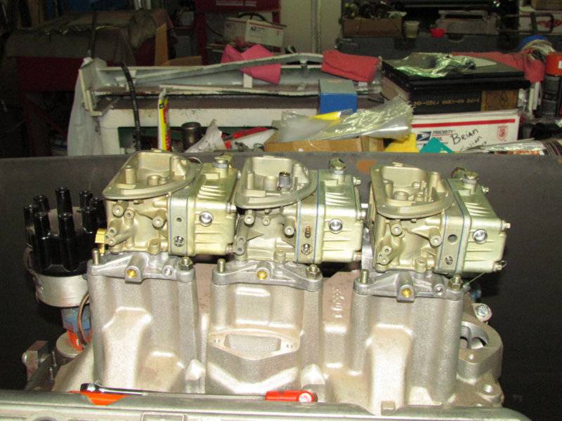

when jet blocks are added to the end carbs there's not enough room to install a center pivot bowl on the rear carb. thus all are converted to side pivot. no mechanical carb is factory.

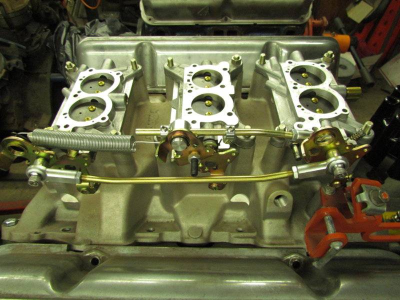

I have Factory vacuum Secondaries on my red 70' Charger. They perform great once dialed in. I did just find an old NOS six pack Nitrous (3) plates that I have wanted for years that Holley discontinued in the 90's. Now I have to piece the rest of the kit together & try to make it fit under the hood.

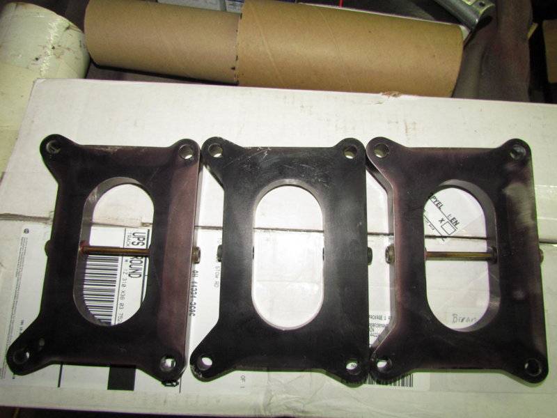

I have 3 NOS plates that I was going to use but now thinking of selling them, if anyone is interested PM me
Can I get a few revealing shots of that system please?
I have a sale pending but here is what they look like
Thank you will look them up on jegs for pricing.

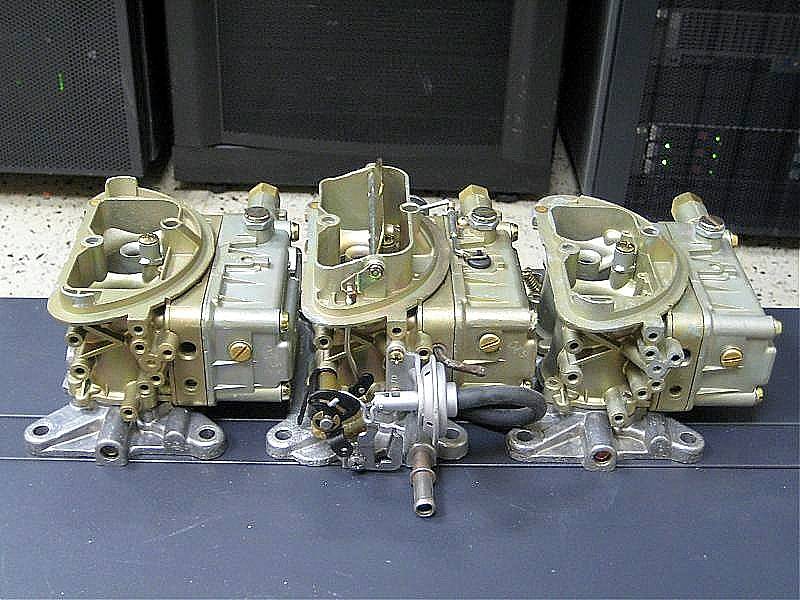

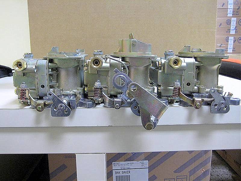

I have a set thinking of selling. direct connection carbs with linkage. I cant figure the year on them. center 3416 outers 0397 anyone? I want to use vac setup do to the air grabber hood.
Just learning about the carbs. I do want to run 3x2 but i don't know what size are they. Need 500 for center outboards 350 is that what you have.
