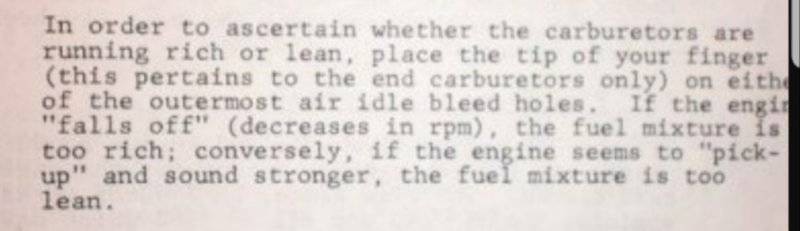

outboard carbs always contribute fuel even when closed so i believe a small adjustment may help.
THIS was an epiphany for me in getting my 6bbl way better:
i know this is a commercial to sell their product, but still the process is a good reference to getting car setup with a good ignition curve.
