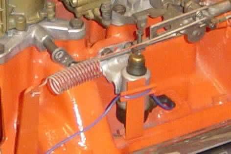

i think you are referring to the idle solenoid that deactivates on shut down to completely close throttle plates to help with stopping dieseling. used mostly for stock appearing setups. as far as i know it does not ease the throttle back to idle. it is used instead of the idle speed screw.
That one does look like an idle solenoid. We just ended up putting a dashpot ($175 +/- dollars for a strange contraption) on a 69 Hemi and I had noticed something similar on pictures of original six pack cars and thought it was the same thing. But now that you point it out - I do remember the six pack cars had idle solenoids. Damn - it's miserable getting old and forgetting stuff.
