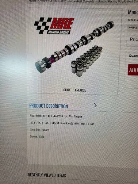

Yes i have to agree with you, way to big of cam, has anybody used a old purple shaft grind from mancini, for 380 i can get the cam and the lifters, not too sure how good of quality the lifters are though, last cam swap i used johnsons from hughes, time before that comp lifters but heard bad things about them now, what you guys think of this cam for my 413
