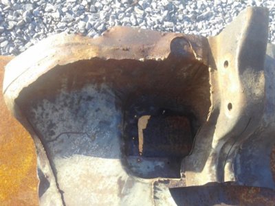

Check out how the factory did the tunnel on the original floor-shift '62.
That looks like the floor is cut out and the hump is welded in place. The first pic I posted is an unrestored original car, the hump is set over the carpet.
Maybe early builds were set over carpet, later welded in?
The first pic I posted also has a round top/shifter boot, and looks higher. The last pic definitely looks lower and square.

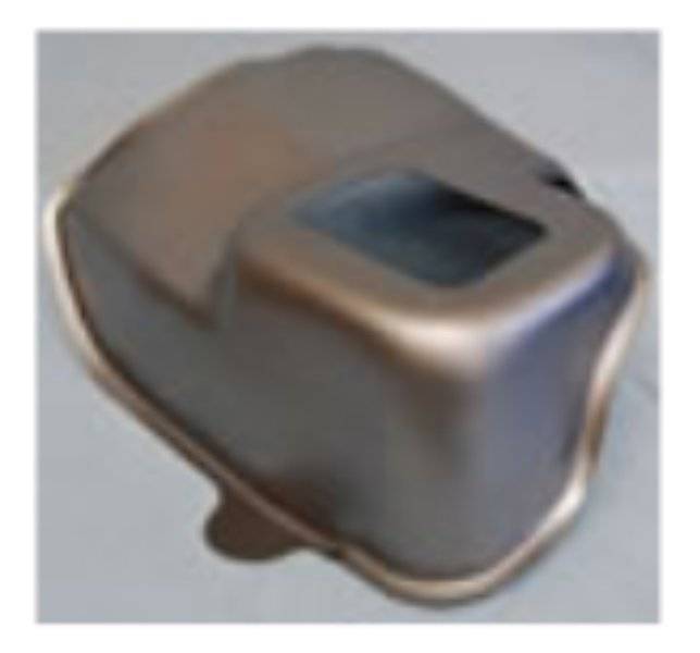

Just checked Brewers, the new hump has the same shape as original with a square opening.

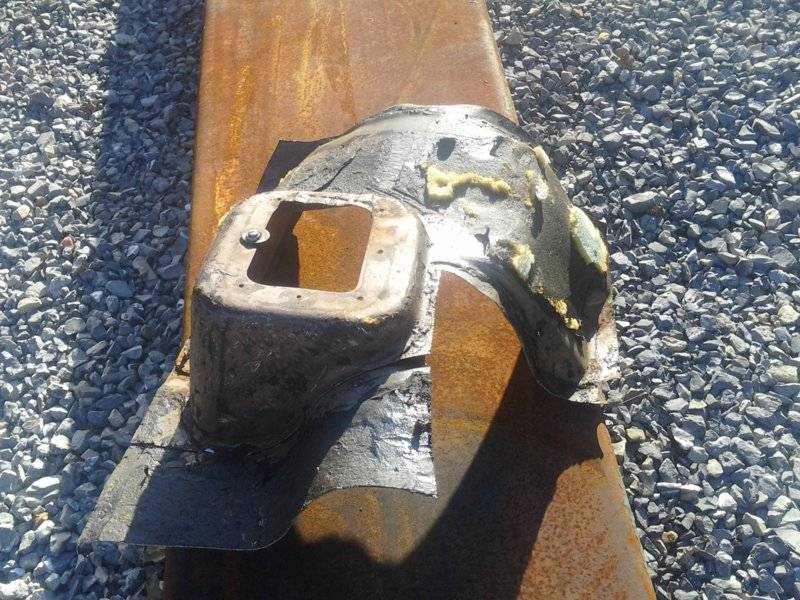

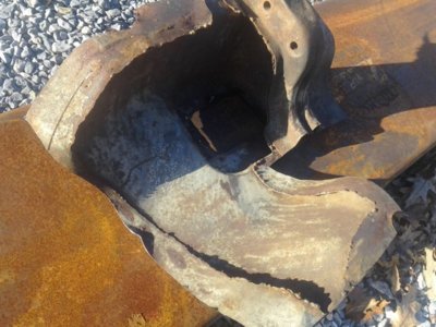

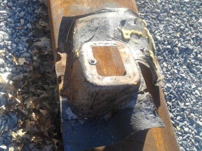

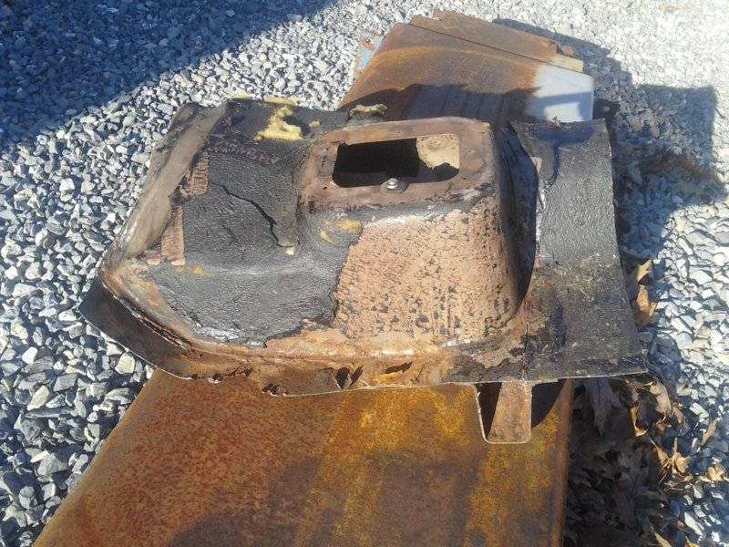

The pics are out there of what they look like...nothing saying you can't make your own it's all in what you want to spend vs. what you want to build and design...you just need to trim the existing floor out everywhere the tunnel is to be installed...
I attached pictures of one I cut out of a 65 Belvedere a while back...I assume its a factory piece...I will use this on my AWB car but I am going to bolt it in with inserts in the floor since i'm not running any carpeting...I plan on duplicating it to weld into my 65 Belvedere floor.

That hump looks just like the new one available.

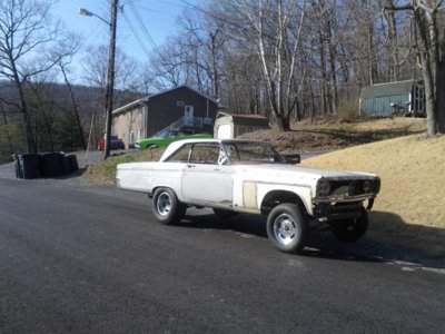

Speaking of awb, this one was next to the wagon I bought. Only the rear is done, no engine or interior.

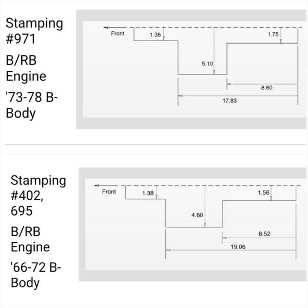

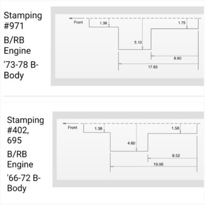

The engine I have now has a 402 pan. Anyone know if it will fit?
Dimensions below.
Dimensions below.
