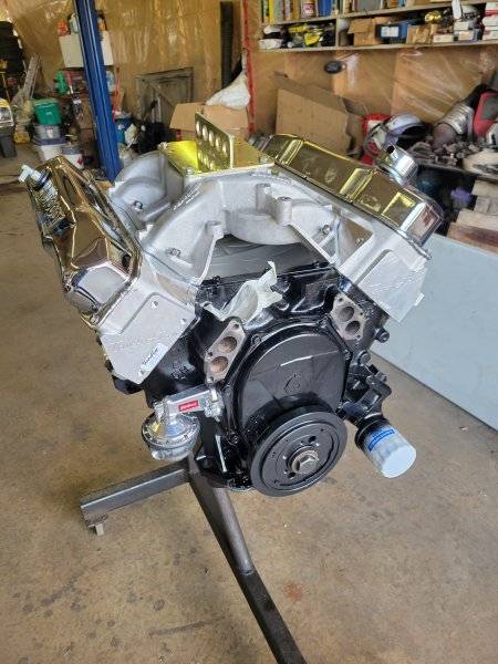

What size is this one?

Damn you're good..
So, that's what that engine is? I've actually never seen one but only assumed it was built like all the other RB blocks. I know there were some changes made to the outside water jacket wall on the later years but am not aware of any other things that may have changed over the years.
Well... not really.
It's a 440 built like the trickflow dyno mule.
