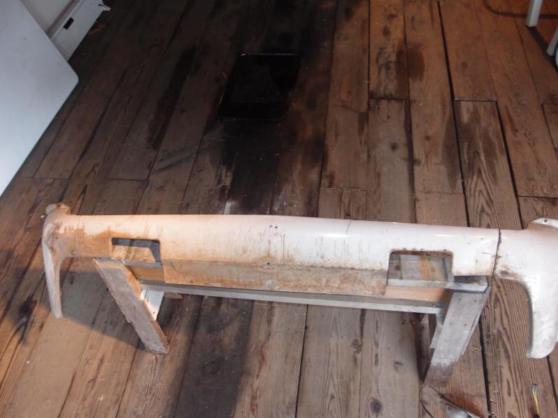

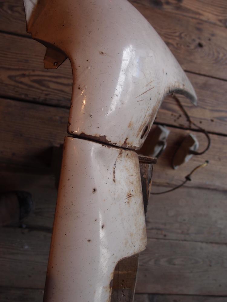

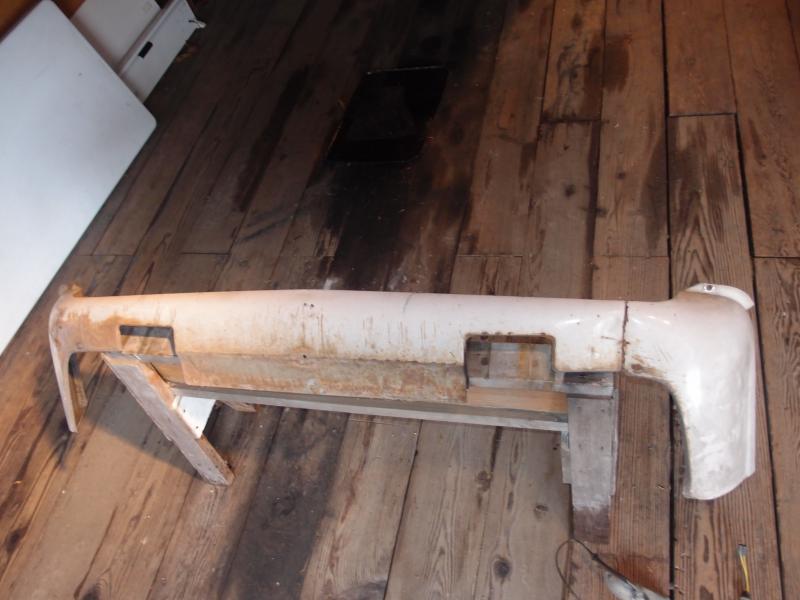

You can kind of see in the picture that there is a piece that attaches to both lower fenders. Called the valance. I've got a picture at home that I can send you later. furyvalance.jpg

It is a 3 piece valance and I can make you a new fiberglass one piece unit out of fiberglass. My wagon has one.
on the underside of each fender there are I think three bolts. There is also a center piece that ties into the radiator support.
Upon reviewing the images myself I see that they are not the greatest. Hope it helps though.
Yep, that's the piece I make and it bolts up like original and you bolt your turn signals to it. Sold quite a few of them and they are easier to install.
